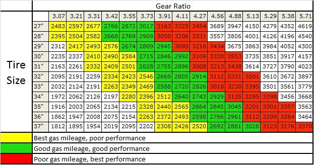

My truck is doing around 2150 at 75 mph with 31" and 3.55. What speed is that chart set to? Or is it for c4/c6 (no od)?

cbans wrote:My truck is doing around 2150 at 75 mph with 31" and 3.55. What speed is that chart set to? Or is it for c4/c6 (no od)?
Most of those matrix charts are based on 60mph in a 1:1 gear... so 3rd gear of a c6 or E4OD.
