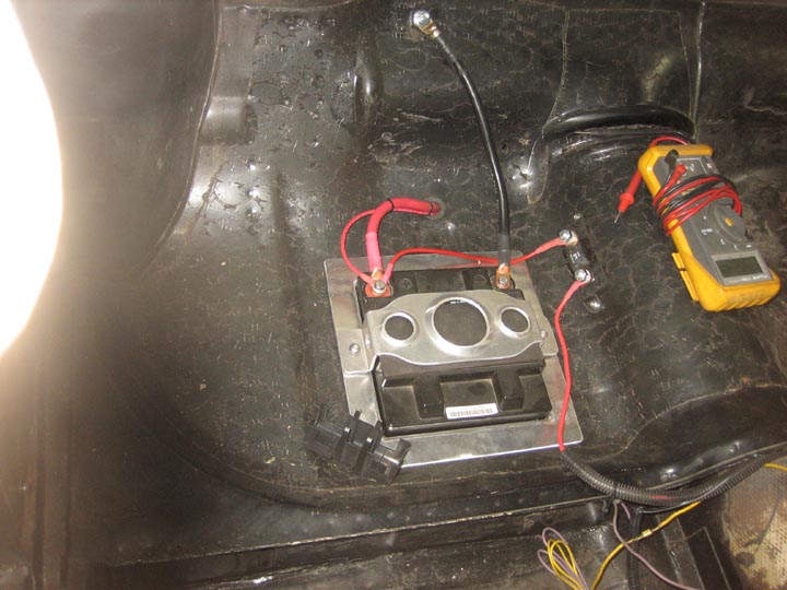

I like them sunk when possible. The ones in the blazer were going to be partially sunk - kind of like the one in my alfa (pic below), due to space limitations, but when possibly I like them completely sunken with a trap door (piano hinges & a dzus tab make this trick!

@ Steve thats a slick install on the battery you guys have definitely given me some ideas
