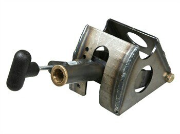

On my Bronco I am ditching the stock colum after the 3rd time breaking the tilt steering. I got a tilt steering setup from Kartek. I had a I had a Contingency sponcor Credit several years back and it didn't cost me anything otherwise I would have fabricated something similar myself. They are around $185 now. I like letting the girls drive. I even had one I taught to jump the Bronco. [attachment=-1]uploadfromtaptalk1395036352961.jpg[/attachment]
Re: steering wheels
If you want a pull pin tilt columb let me know, I sold the same one pictured to my friend for 50$, that's a very hard thing to sell when you change your mind like I did. I can get you in contact with him if you want it. It's been collecting dust in his garage for 2 years now and I'm pretty sure he'd sell it.
