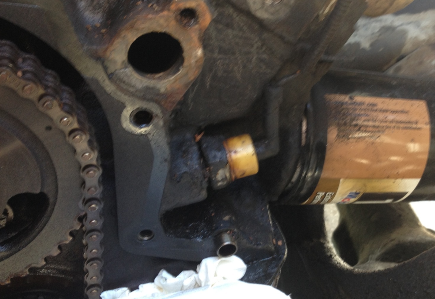

Make shure u pressure wash it, your oil pressure sending unit is just above the oil filter housing and can leak down looking like its comming from the filter housing,driver side pan gasket, filter housing ect. Could be an easy fix. As u probably saw mine is another location. :(

Re: Oil pan gasket
Here's that pressure switch.
