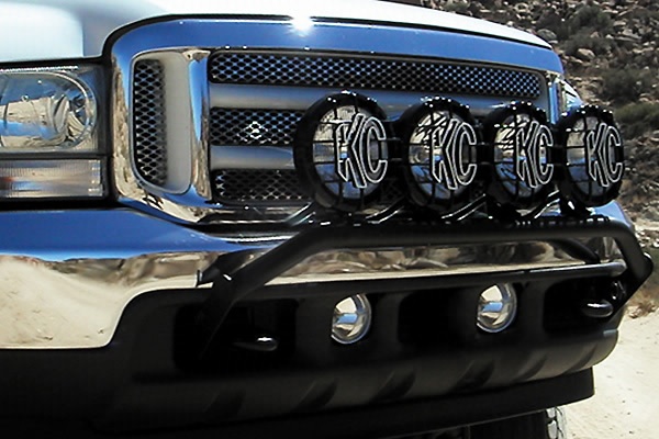

I was thinking of something to this effect ( I'm aware this is an f250). This idea but flat bolt on plates to the front face of the bumper.

I have the same super duty KC bar pictured above. It works ok. The mounting point is good. It is the same as the tow hooks so pretty solid. Unfortunately the flat connectors side plates between the good mounting point and a decent bar need some work. Not sure if it was intentional but the logo is lasered in the weak spot and it doesnt take a big bump ( read not a nerf bar) to kink it back. I need to put new plates on mine now and some gussets and it will be pretty stout. I think if you chose your mounting points right you could make one bolt to the bumper metal fine without too much jiggle. My lights were just for cow/deer spotting on highways.
