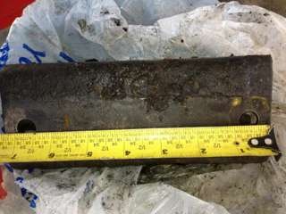

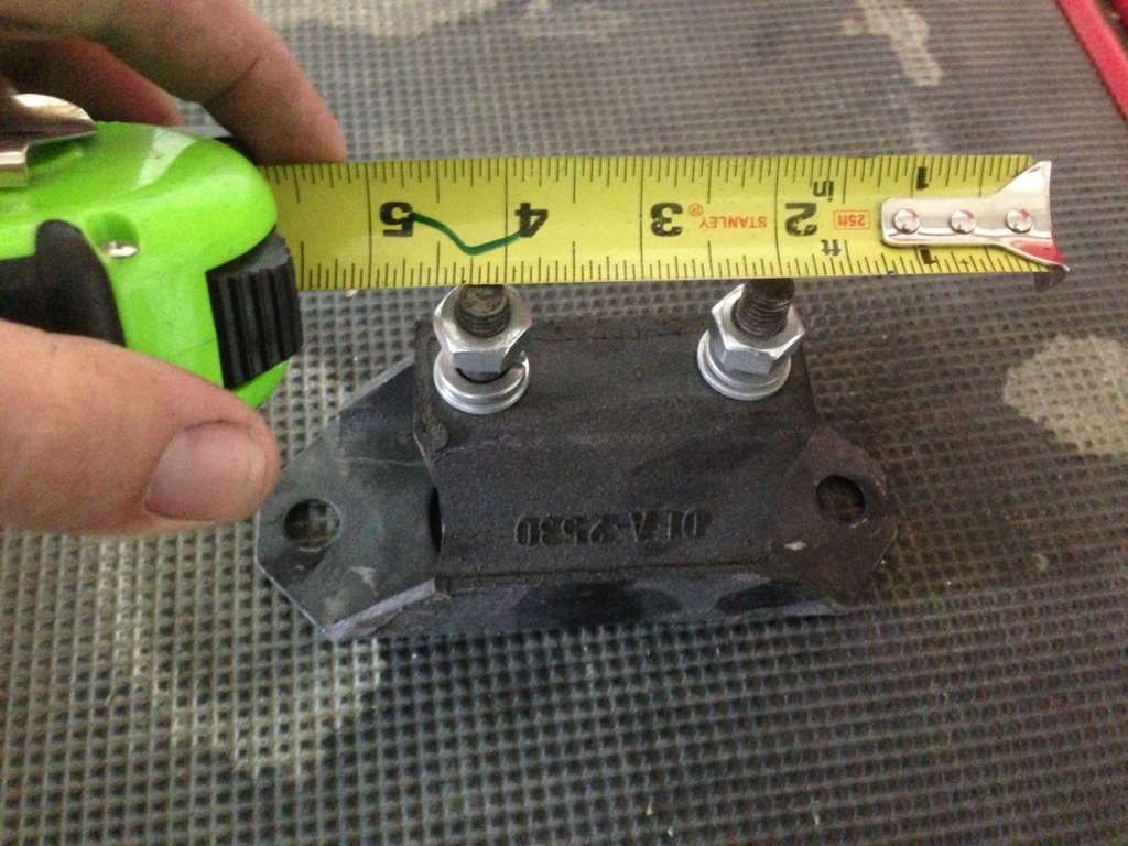

This weekend I went all over hell and back trying too find the rite trans mount for the bronco. I have an 86 w/5.0 and aod trans.
All the mounts everyone caries are narrow by a half inch at the mounting holes too the trans. Here's a pick of what I got. Any and all help would be grate

Looks like this one by appearance
http://www.napaonline.com/Catalog/Catal ... 0289638068
Whats the date of manufacture on your truck? Maybe its a early 86 and parts are actually from 85 or late 86 and parts are 87 ? Did you try going up or down a year and see what they pull? Try rockauto.com ? They have pictures and measurements of almost everything they sell.
Re: Trans mount
Looks like the mount from an e4od but that cant be right.
Re: Trans mount
According to rockauto the 1968-1986 Bronco (1977-1986 F150 too) has same mount (or that part number fits them anyway). Maybe go up a year to 87 after that cutoff?

Greaslife that's the same looking mount as my 84 with a C6 fyi.
I know cause I broke the stud off that comes though the cross member. Drilled out out tapped it for a course thread 7/16 bolt. Threaded the bolt in the mount till three threads of bolt stuck out inside the rubber mount part. I then mig welded it on the top the best I could (What a smokey mess welding next to rubber does), then I welded it on the bottom where it sits on the cross member. Grinded down that last weld so it sits flush on cross member, bolted it back on.
Went to the junk yard this weekend and pulled a new one off a bricknose F150 assuming it was going to be the same, it did not bolt up, stud spacing was off :(.
Guess I am stuck with the hack tranny mount for a bit.

Ford used two different styles. A car and a truck mount. If the truck stuff doesn't work order a mount for an 80s mustang. I have both at the shop if you need measurements.

Thanks philo that would be grate if you could get me some numbers. I thought of going that rout but didn't think ford would put a car part on a truck.
Re: Trans mount
What is the width on the crossmember side? I have two that are wider than this one.
