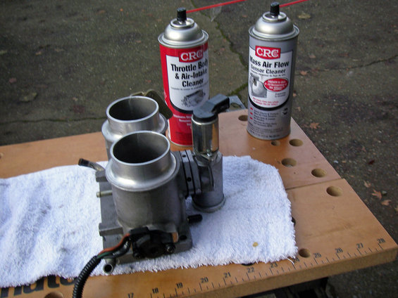

Clean the Intake Manifold, Throttle Body and IAC and consider if port matching Intake, gasket and head is in order.
