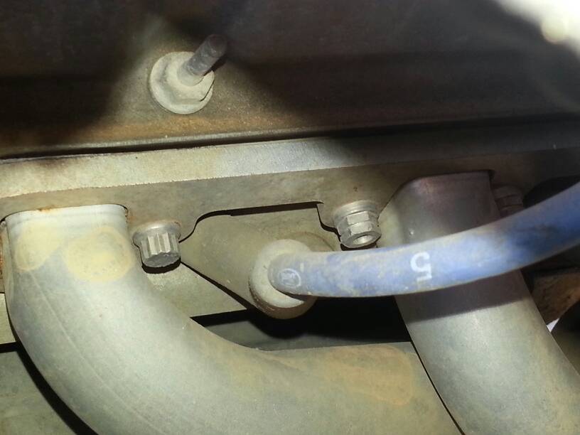

Any reason why there would be only 1 like this? All the others are like the one on the right. I have to replace the header gasket on this side, just wondering if anyone else has ran into this and the best way to approach it. Clearance is to tight to get a socket on it... the others hav an allen in th middle ot them making it much easier. Any help is appreciated.

Is it a smaller socket size?
Arp makes some header bolts with a 1/4" or 5/16" head size with a full size flange that are spendy but worth it.

No same size but due to the bend in the pipe i cant get a socket on it... it just seems strange for it to be th only one. I dont have a 12 point wrench either, yet haha.

The one on the right looks like a Stage 8 brand locking bolt but missing the lock plate and e-clips. probably lost one and didnt want to buy a whole set.
Re: 12 point header bolt??
12 point box wrench should get it done, no?

Yep i do see why not. Just thought it was odd that it was the only one. I think MOSS hit the nail on the head. I picked up some new header bolts so ill swap that oddball out when my gaskets get here.

Shitcan the header bolts and get allens. Those + an extended ball drive allen socket will make your life sooooooooo much easier.......
Remember, get it good and warm then retorque.......

Top tip. on some of those really tight ones, you have to put the bolt in the hole before you start bolting the header up........

Thanks for the tips. The new bolts are hex and also have the allen in the middle so do the the ones on the headers currently. Other than anti seize on the bolts (i have aluminum heads) is there anything else i should know?? Thanks for the help guys.

When I originally put all that together, the Stage 8 bolt wouldn't fit in that one spot. And none of the Stage 8 hardware fit--besides the bolts. The one 12-point bolt allowed me to tighten it up without flipping the wrench every turn.
As an aside, I've always had problems with Ford small block manifold bolts breaking, and the Stage 8 bolts seemed like the best fastener option at the time.

After i got the header off i could see why you might have used another bolt, the stage 8's were about a 1/4" longer than that 12point and made it much easier to remove especially due to the bend in that particular area of that header tube. I used a bolt of the same length as that 12 point to replace it and im glad i did, a longer bolt would have been a real pain in the ass to reinstall. Im just glad to have a little power back and no more lawn mower tick!David Kennedy wrote:When I originally put all that together, the Stage 8 bolt wouldn't fit in that one spot. And none of the Stage 8 hardware fit--besides the bolts. The one 12-point bolt allowed me to tighten it up without flipping the wrench every turn.

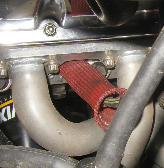

On my 72/5.0 the bolts are a mix because the Duff headers that the PO installed have terrible tube to bolt clearance. I should get some of the ones pictured above (assuming they are 12 point?). Now I have regular hex in places that fit my socket and allen/hex in the tight places. I still have to use an open end wrench on the close fit ones.
I am getting skilled are R&R the headers cuz everytime I look under the thing the darn right side has to come off. Going to have to do it again becaues the tranny dip stick tube is not seated. Sigh
Another header brand would be in order to fix all the hassle.
