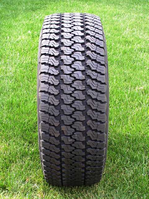

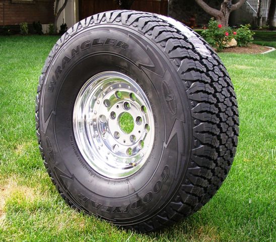

I have 35x12.50-15 Goodyear Silent-Armors on 10-hole Ford 15 x7.5" aluminum 'rivet' wheels (Hollander 1701).
No issues whatsoever. Running stock PSI's front & rear, with only slight wear on the fronts...mostly due to the camber changes.
Go for it.
Go for it.

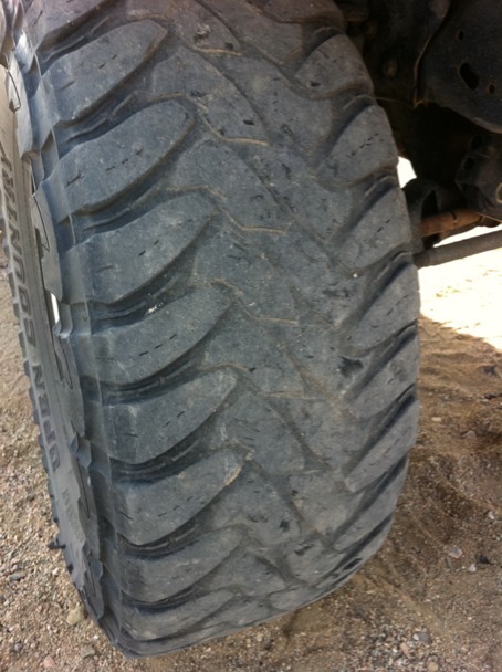

After 60k miles on 9" wide rims. 37x13.50x17 tires.
- ImageUploadedByTapatalk1327857844.696685.jpg (82.62 KiB) Viewed 1657 times
