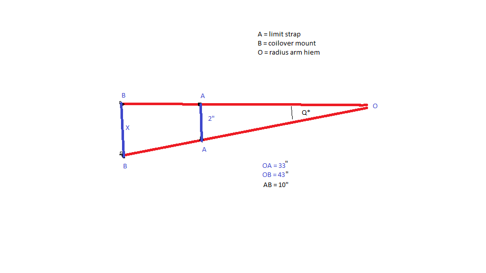

I've got all the #'s to solve this suspension geometry problem but don't have the brains to do it anymore. I'm looking for the length of B to B. I think angle Q is approx 11 degrees (but really not sure how i got that answer :D ). I've been plugging away at this for hours now and keep getting different answers. I want to know how far the coilover (B) will move if the limit strap(A) moves / bottoms out after 2". :mrgreen: It is 10" further away from the pivot point (0) being the radius arm hiem joint. I think its crazy how i used to have to know this junk for tests in high school/college, I guess i should have paid more attention.hahaha

Q is actually 3.4°
for 2" travel at A-A travel at B-B is 2.6"

Just take the ratio of the two distances and multiply by how much they move.
OB/OA * 2 = 2.6"
You can flip OB and OA if you want to know how far A moves if B moves 2 inches.

aaahh, thanks guys. I acutally had Q of 3.4 from one formula but got the 11 from another. Looks like i need a longer limit strap. Thanks again

Your second limit strap is less than .6" longer than the first?

Oh, wait. You just want your coilover to travel more...?

Yes, i need a longer limit strap at A so that the coilover (B) will have more droop.

Copykat wrote:Q is actually 3.4°
CAD is an awesome tool. No math required.
Confirmed from the math handbook . The arc length is 2.606"

I am late to the party but a quick scan I didnt see an arc length formula, just answers.
S=R X Theta
S is arch length
R is leg
Theta is angle in radians

Phoenix0783 wrote:Just take the ratio of the two distances and multiply by how much they move.
OB/OA * 2 = 2.6"
Remember that this works for right triangles only...
OB/OA * 2 = 2.6"
True, but with that small angle, it ends up being close enough.
