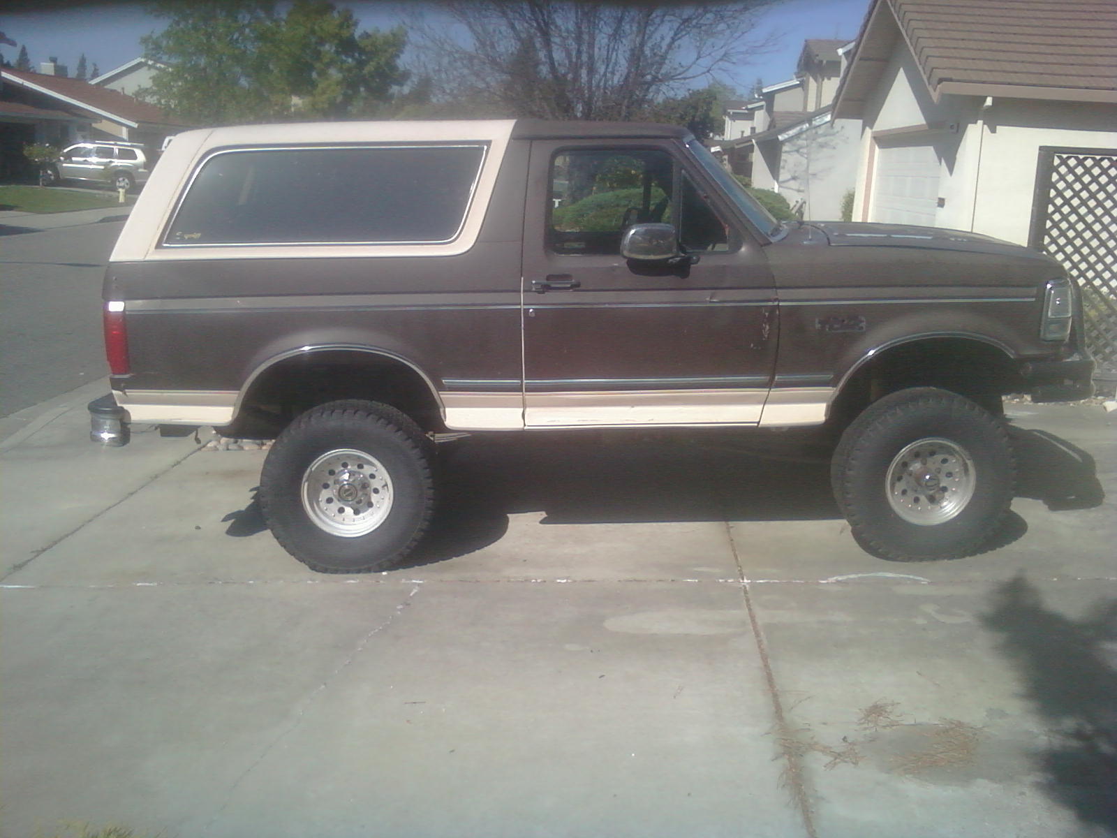

I have the 4.5" Superlift lift leafs with 3" blocks (3" on the fat end in back, ~2.5" on the front) on top of the factory wedges and lil pinion shims. My truck currently sits even with the totally unused 5.5" deaver coils I put in front, and with the expected coil sag will sit slightly higher in the rear, which I like for an even stance when loading up the rear.
(Ignore the tiny lil' tires, she will be running 35s)
Soooo, JBG lists the Deaver J40s they sell as 4" lift springs. I intend to get the OE perches cut off and some longer length pad perches put on at the correct pinion angle. I have f450 front hangers (~1.5" longer) that I can use for the new spring setup. If I drop the rear hanger 1.5" or so can I also use longer shackles (5", 6"??) to make up for some of the height lost by eliminating blocks and having .5" shorter leafs without screwing up the ride quality (more concerned with onroad stability...)?

The J40's are definitely NOT 4" lifts, they are much more. I have Deaver 5.5's up front and J40's in the back with extended camburg shackles and no pinion wedges, and the rear is level with the front. I would say the J40's are more likely a 6" lift when new.

I've got superlift's 6 inch lift up front and J40s with no shims/blocks and stock shackles in back and it sits almost perfectly level... point being that the J40s are more than 4" of lift. I haven't put very many miles on my J40s yet, so I don't know if they will end up settling a little bit, but for now they are more like a 5.5-6 inch lift springs. I do really like them though.
