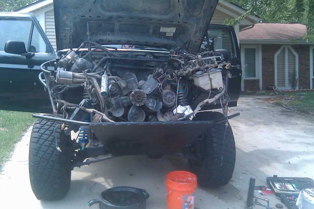

this is a question mainly for guys who have "off-road only" trucks, did a search can't find what i am looking for. i want to delete the smog equipment, including EGR on my truck, for various reasons, main being clearing up room for engine cage and lightening my load up front and also because i want to run aftermarket headers. its an 97 EFI 460. i know there are egr deletion kits i can purchase, but what else am i getting into with this. am i going to have a lot of problems making this truck run right after this?
also, on a side note this is what i have been doing all weekend. trying to pull the heads.... would have had them pulled but the egr tube is bolted into the back of the the drivers side header, and then another tube from the egr, runs along the firewall to one of the canisters but has a bracket that is bolted to the back of the passenger side head!!! ahhhhh!!! ADMIN EDIT: Post above merged into this one from another thread.

Re: Removing "Unecessary" EFI Components
thanks... i swear i searched! but i like how i got added to the thread about having messy work.... best i can do, i cant spend $2000 getting this job done at a shop.
