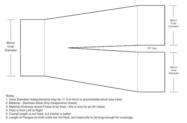

Without any success, I've been looking for a better off-the-shelf alternative for the undersized plastic 'Y' pipe that everyone seems to be using to connect our single mass-air meters to our twin-blade throttle bodies, as I believe that the current 'Y' pipe must be restrictive - it's just waaay smaller in diameter than my 80mm mass-air meter or my twin 56mm throttle body.
So I drew up a sketch of what I needed and sent it to 4 of the bigger custom stainless exhaust/header component makers, asking for quotes. The lowest price I received back was $95 for one unit, which I'm taking them up on even if no one else wants one, but I've also asked what kind of volume discount we could get.
If you have any interest in buying a unit at $95 (potentially less), please reply here. I'm also posting this on FSB, so maybe there will be decent interest.
Here's the draft sketch and the comments I submitted for the quote - this is not final and can be tweaked, so give comments if I can make any improvements:

The image above seems like it was too big, so here's a smaller version.
- Screen shot 2011-03-01 2.png (81.9 KiB) Viewed 2689 times

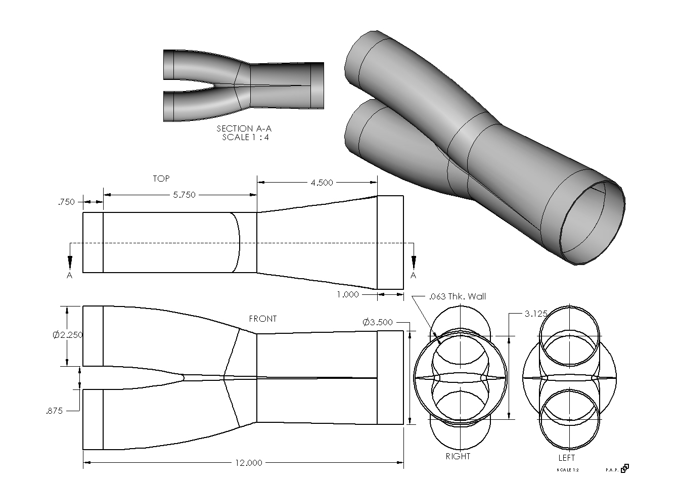

I'm looking to make or get one made that has a 90mm MAF side and 61mm TB side with 15/16" gap

The same guy could do both I guess. What do you think about the pricing?
Also, I'm assuming you have a BBK twin-61mm throttle body - I have the twin-56mm BBK and took a rough guess with the .5" spacing between the tubes. So your number of 1" is probably the right one for my throttle body as well.

I'm whipping up a model/drawing of what I'm hoping for...

Drawing based on measuring my 61mm BBK with calpers.
- solid model also available
- ypipe.JPG (216.8 KiB) Viewed 2624 times

Sydude, I'd definitely be interested in ordering something similar to the drawing I attached above!

2, 56 mm tubes feeding 1, 80 mm tube is restrictive is portmatched within 2%. Did I misunderstand?sydude wrote:Without any success, I've been looking for a better off-the-shelf alternative for the undersized plastic 'Y' pipe that everyone seems to be using to connect our single mass-air meters to our twin-blade throttle bodies, as I believe that the current 'Y' pipe must be restrictive - it's just waaay smaller in diameter than my 80mm mass-air meter or my twin 56mm throttle body.
2x56mm bores = 4926mm^2
1x80mm bore = 5026mm^2

Yes, that's not what I meant. I'm talking about the bore size differences between the stock plastic wye pipe and the much larger bore sizes of the throttle bodies and mass-air meters. I don't have one at hand to measure, but eyeballing it it looks like it's got a 50mm opening on the single inlet side coming from the mass-air meter.shockseals.com wrote:2, 56 mm tubes feeding 1, 80 mm tube is restrictive is portmatched within 2%. Did I misunderstand?sydude wrote:Without any success, I've been looking for a better off-the-shelf alternative for the undersized plastic 'Y' pipe that everyone seems to be using to connect our single mass-air meters to our twin-blade throttle bodies, as I believe that the current 'Y' pipe must be restrictive - it's just waaay smaller in diameter than my 80mm mass-air meter or my twin 56mm throttle body.
