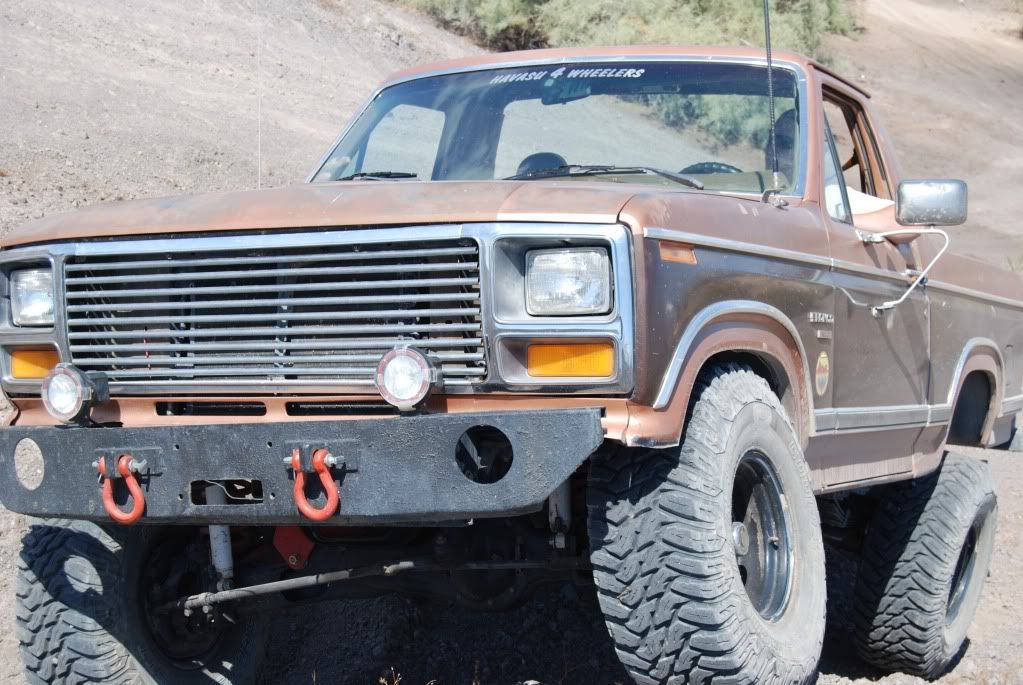

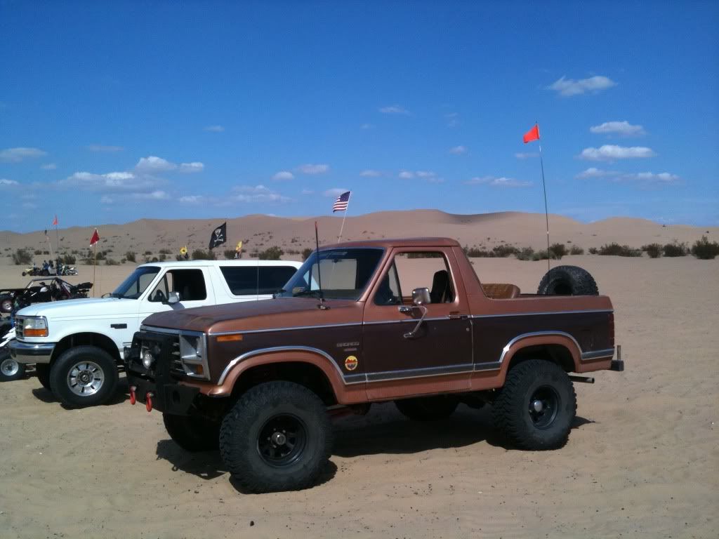

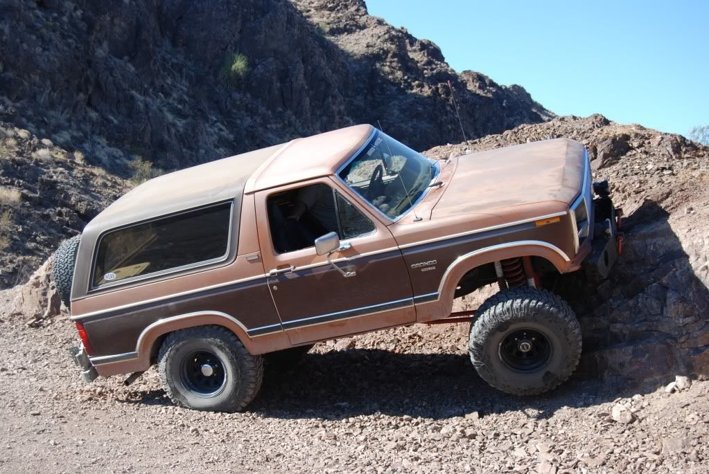

I used the 15" measurment with my 4" lift.
Wishing I had done 14 inches now, as I rub the back of the fenders a bit at bump, but have clearance up front.
Glad you got it figured out and it works well for you.
although it looks pretty decently centered when stuffed and drooped
