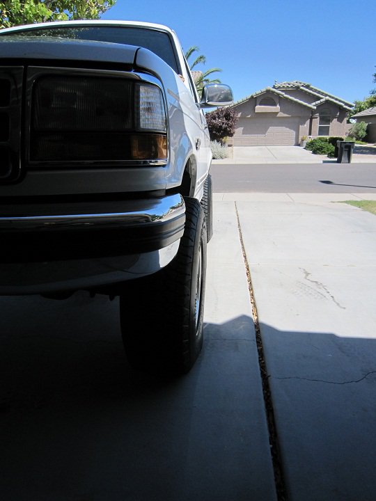

The steering wheel is a little off and pulls to the right so the bronco is going in for an alignment soon. How much camber should the front tires have? Ive attached a pic to show what im working with.
- camber.jpg (67.92 KiB) Viewed 1338 times

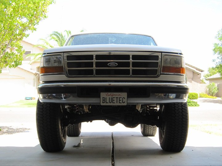

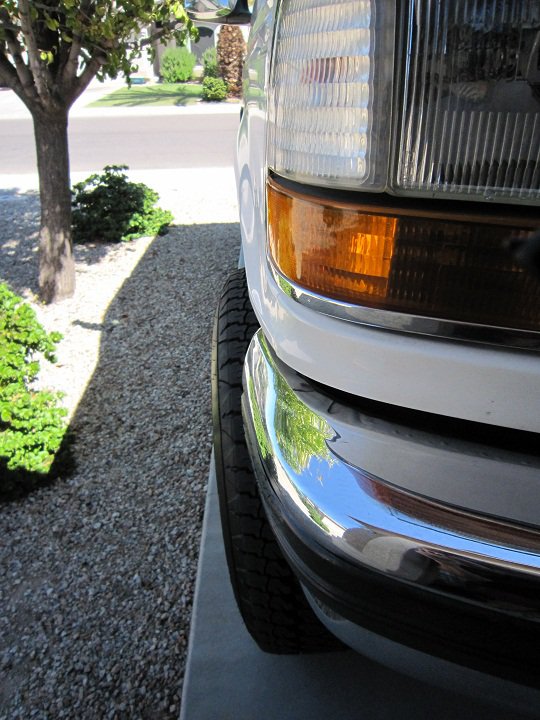

driver and passenger shots
- passenger side.jpg (96.71 KiB) Viewed 1337 times
- driver side.jpg (56.73 KiB) Viewed 1337 times

I run mine at 0. +1 is ok too. Toe and caster split are a more important though. 1/2 to 3/4 more on the Right (pass) side is a good start. 1/16 to 1/8 toe in is perfect.

Depends on who you talk to. That is definitely too much positive camber though. 1/2 degree of positive camber, 1/16 - 1/8 tow in, and as much caster as you can get works well for me. Seems to wear evenly are ride nice.

+1 to -1 would be acceptable, but I prefer 0 to -1/2. Although, I ran a bit of positive camber on my Bronco and 2wd F150 without issues.
It looks like you have too much toe in too, maybe why it pulls. What kind of alignment cams are in there now? Toe in will depend on wear of the steering components. Newer stuff gets less toe in, old sloppy stuff gets more so when you get rolling it winds up straight. Be careful of excessive toe and the death wobble and or wandering. Too much toe in can give you more positive camber too.
A decent alignment can be done in the driveway. Basically, I would set the alignment cams to get you camber first and set your toe after, drive, center wheel with tie rods, drive, recheck your camber, recheck your toe, adjust, drive. If there are adjustable cams (JBG) run the excess into the caster.
Re: How much camber for cut and turned beams?
Remember that camber and toe work together. A wheel riding on it's edge turns a little.

This truck does seems to have more camber than other cut-and-turned beam trucks. It currently has the Superlift adjustable camber sleeves in the upper ball-joint locations. Various lower coil spring seats and coil spring combinations have been fitted to the truck to try to dial it in. Autofab suggested that the coil springs need to be pounded on to get them to settle... but I never got a chance to do it.
I like the idea that Brian had of machining down the factory lower coil spring seats (http://www.gofastbroncos.com/forum/view ... ?f=9&t=946) which would lower the front ride height and reduce the camber. I also have friend that's making custom height lower seats out of steel for dialing in TTB ride height.
