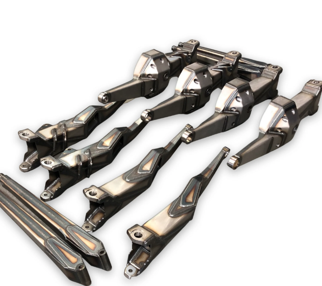

I'm gathering parts to put the OchoFab beams on Wilson... anyone know which Trutrac fits the 81-83 TTB D44 with the bolt-on axle?

Found it... I need the 913A592, which is for gear ratios numerically higher than 3.92. Ordering!

Haha. Yes. The car works so well as it is... to say I'm hesitant to change anything major is an understatement. But, the front beams / arms have been repaired A LOT. Before we got it and after... and recently.

Current is a Trutrac... works well. But I want to assemble the axle-housings completely before tearing the car down. I hate downtime! Plus, this leaves us with a functioning spare front diff for Wilson and White Lightning.

Yup. It works well, so I'm just replicating the setup.
