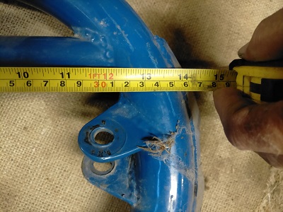

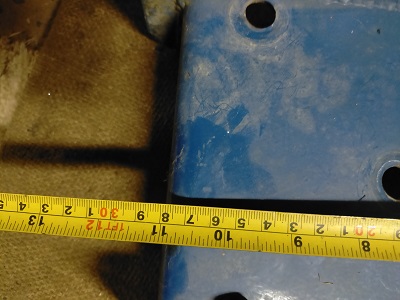

I’d love to know how tall the actual bucket is? From bottom of frame to top of spring. I’d also like to know the height of the shock mounting eyelet from the top of the coil mount?

When I have time, I'll measure them for you.

12" from top of bucket to shock bolt hole centre.
10 3/4" from coil seat to underside of rail (allowing for bucket material thickness).
Hope that helps, sorry for taking so long.
