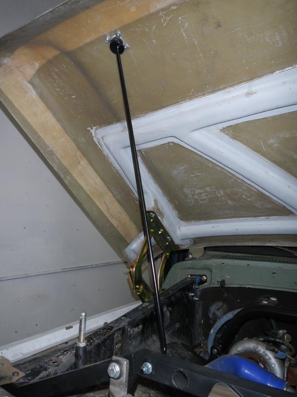

Remember the old rule. "keep it simple stupid" Thats the rule i live by. why buy all that stuff that will eventually fail.A simple proprod like the ranger has is good enough for me. If your lazy get the gas shocks. The average glass hood will buckle if you leave the hood springs on,they arent built to take the abuse, the reason you get a glass hood is to reduce weight or change the design. To me engine cooling is paramount. Or you can do what travis did, put pins at all four corners and then have a hard time getting the hood off by yourself. Its a matter of personal preference. Ill stay with simplicity. You can stand on our parabeam hood and not buckle it. Ive only been doing this for fiftytwo years, although im sure I still have more to learn.

Good thing is i have a ranger hood prop already. I ditched the springs when i did glass fenders. For my old pins i welded a plate to the top of the core with a nut welded on the backside. Worked fine but now my autofab pins are bigger and it will be a pita to cut them off. But guess i gotta do what i gotta do. Let me see if i can find a pic of there location. You can see it started to tear a little. Maybe this time ill make the plate U shaped so it welds to the front and backside. Think its a good laction to stay with?

And as for the hood prop - they're easy. Here's one I made for the crew. Made it out of one for a dodge I think.
