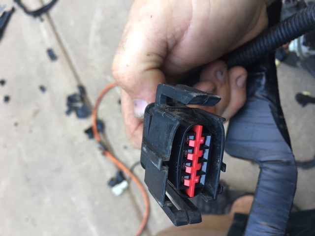

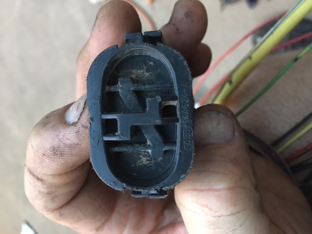

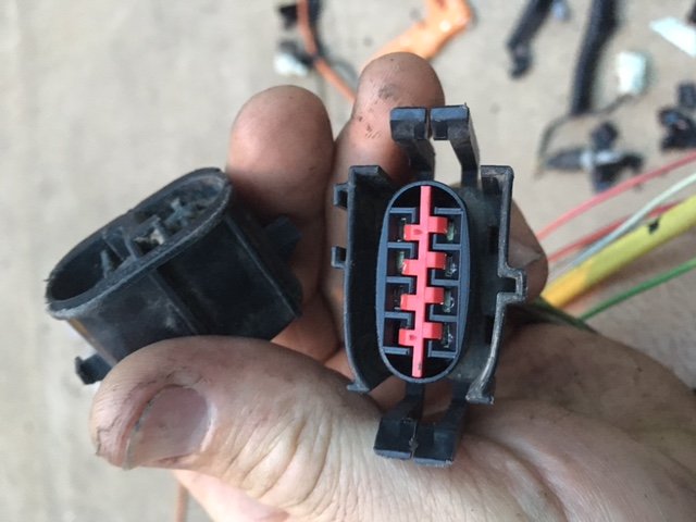

Does anyone know if the F150 abs different from the Bronco on a 95 year? I had the RABS module on the frame I unbolted and I'm missing the pump and line and such like my 96 bronco has. I'm just doing a wiring harness swap from a 5.0 MAF truck on my 5.8 and there's an oddball plug that I can't seem to figure out.
Here's the pics of the plug and it comes out on the driver side part of the harness where the harness goes thru the plastic pieces on the radiator support.
As a side note I do not have the abs sensors on the front knuckles.

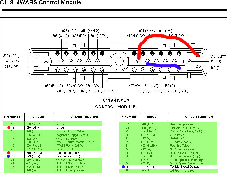

How I read this - which to me is pretty damn confusing-- you unplug the ABS pump connect the 2 sets of wires and then methodically go through and delete all the wiring as all the wiring basically just routes through the ABS pump? That's how I read it- if that's the case it's pretty damn easy-- if not well it's nightmare city lol. Personally it would be great to have a non-postable sticky that people could follow and not comment on.

Agreed! What confused me is that some posts claim that the ABS and VSS system are completely separate and don't affect each other and some do. The diagram above tells me they are connected somewhat. I know that my vehicle starts to act funny only when the ABS light is on, which isn't all the time and the speedo jumps around regardless of ABS light.

Just did this to my 96 and this absolutely works as pictured and the wire colors are correct - I used the larger orange-blue wire as my reference point on the connector. The diagram with the red and blue lines above is being shown in the same view that the actual picture that I just attached. I did also confirm that just removing the frame rail sensor will rend the speedo inoperable, trans not shifting properly and the OD light on the shifter to flash.
