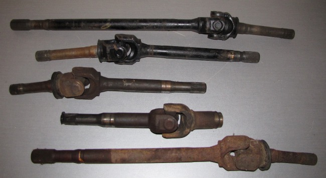

Re: TTB vs. THE WORLD (AKA differences between Ford TTB axles)
Picture:
The top two axle-shafts are D44 TTB, the three below are D35 TTB
I'll measure and give dimensions later.
- D44-D44 TTB Axles.jpg (61.61 KiB) Viewed 3277 times
