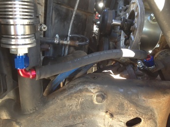

- funinthesun95
- Posts: 1701
Re: Sag pump conversions
Paul I think is talking about this see below..... the Can I have on my bronco
- saginaw bronco pump.jpeg (84.89 KiB) Viewed 2287 times
- howe set up 5.jpg (38.36 KiB) Viewed 2287 times
=funinthesun95 wrote:Paul I think is talking about this see below..... the Can I have on my bronco
Kinda hard to follow this discussion. I think he thinks he has a bracket issue and I suggested he look at the can adapter. Bottom line is he will have to do what the rest of us do and that is start buying stuff and see what fits.
I have that PSC can on my EB replacing the stock Sag can.
Now the discussion is about the horseshoe bracket adapter.
That horseshoe adapter is a PSC version of a long forgotten one that was made of cast iron. I have the original cast iron one in my pile of stuff. I never figured out how to make it work with the Ford cast aluminum bracket.
Anyway there are many kinds of brackets and many bracket adapters and so far only one CAN adapter to make the stock Sag pump work with a remote res.
The later pic shows a typical racer setup I described earlier. It is used with a remote res. and normally with a custom bracket and not a Ford bracket. No can is required. This kind of pump is common for a dual pump setup - one for steering and one for hydroboost. Small and easy to package. Normally very custom fab.
- Posts: 2912
The pic above is what looks like a sag pump that has fitting pick up and is bolted into a e150 bracket.
This pump would be ideal as I can use the psc horseshoe adapter to bolt it into the supersharger bracket and not have to cut the bracket.
Now if only someone could tell me what it is.....
- Posts: 2912
Found it, it is the top of the line lee pump. Out of my price range. Back to the drawing board.
