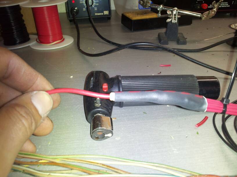

8 wires into 1... not a crimp job. OE-quality heat-shrink with some serious glue that seals really well. Also note the little butane torch in the background... saves the trouble of grabbing an extension cord and heat gun.
