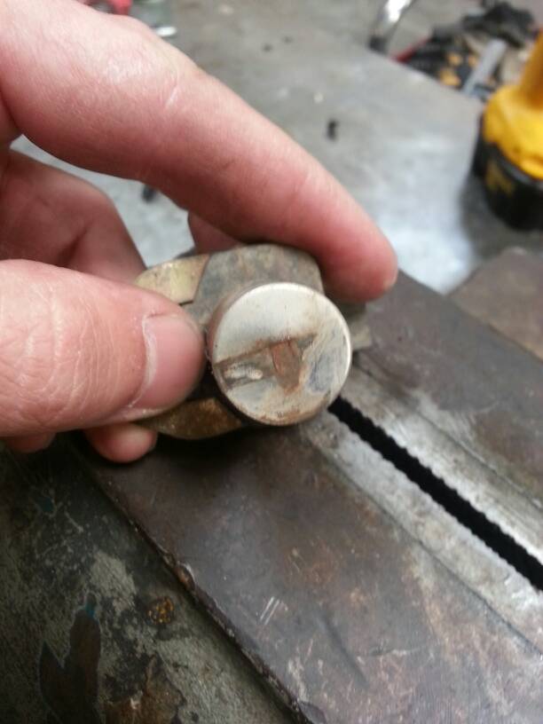

Iac good= 7-13 ohm range
Just had a thought. Have you cut a coke can up to make a sheetmetal block off gasket for the egr?
