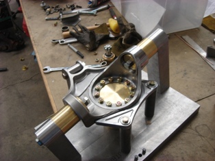

I put brand new moog ball joint in my Class 3 jeep before the 40Th 1000 . They were wasted when we were done ! The old school racers on the team warned me about this!
They say spicer only . When the jeep was at LeDuce last year we talked about joints he say only napa fleet ! He told me that Back in the class 3 DAYS they actualy did research and cut them open! I dont Know if napa use the same vendor but that is what my billet Knuckle are built with. I as so spent a lot of time trying to incorporate himes in this knuckle and went with ball joint.
- You can see the napa gold in the back ground

for what its worth ive had the same set of napa joints in the truck i race for 2 years and they are still good. btw it not as much about the joints as the big stupid cams people use because they have no idea what they are doing with the beams........ with a 5 inch lift i run a zero on the passenger side and a 1/2 on the drivers side to split caster.. Those knuckles are bad ass btw.
