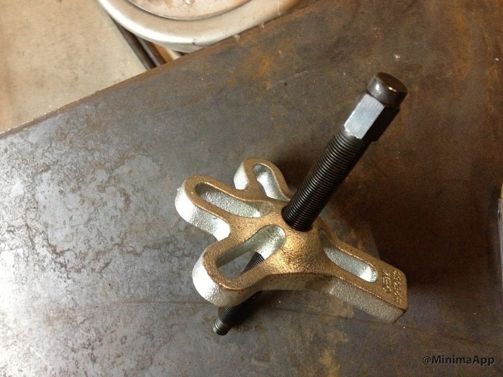

Yes, puller for extraction ( 3 arm puller or bolt in puller depending on pulley style) and the applicator tool uses the center bolt hole and pushes the outside. The boiling expands it enough to avoid galling and slides easy, I can snap a pic of the applicator aka pusher tonight. The center bolt works too if its long enough to get started with the replacement balancer just barely started. You want to be fast before heat is transferred.
Posts: 6026
Re: Excesive shaking problem?
Seems to me I used this style of puller to remove, and center bolt to reinstall after boiling. I think the arm style puller was impossible to use after the rubber had separated from the inner and outer pieces.
Posts: 6026
Also make sure you use something ( removable puller foot aka cap on the jack screw) to protect crank shaft threads. If you ruin the threads you ruin the crank keep that in mind.
