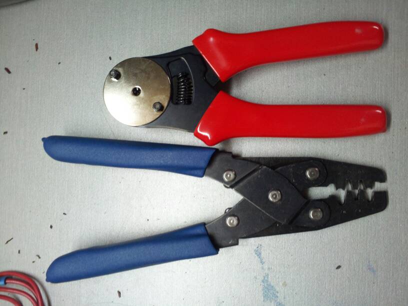

A couple new crimpers I picked up.
Re: Wiring, switches, tools, tips, tricks and more
How do the red ones work.
I believe the red ones work like a iris ( think opening credits of an old James Bond film or a camera shutter), I used to use similar for coax cables. Steve I have a bad ass butane soldering iron ill post a pic of, and also my assortment of pin pushers. The soldering iron I have I got at fry's electronics and has swappable tips the best thing about it is they sell a tire grooving attachment for it.
The red ones are for Deutsch terminals. I don't have any of the connectors but I liked the crimpers enough to buy them. I might pick up a connector kit later.
They crimp the terminals at 4 points. These are cheap crimpers. The high-end tool crimps at 8 points. Bitchin' but not necessary for my stuff. The good ones are also over $200.

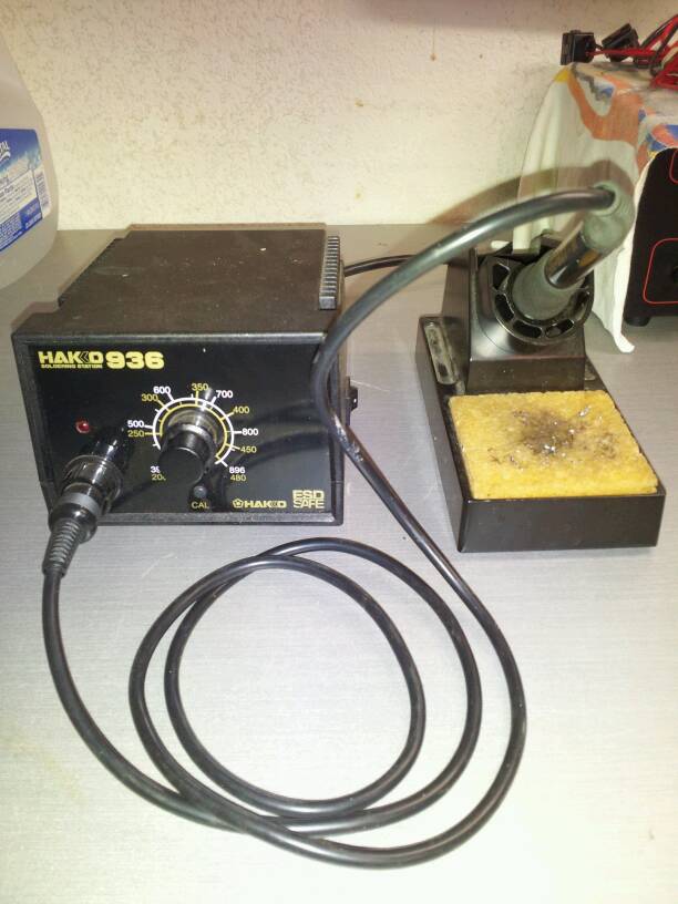

Soldering station.
Admittedly, I'm not sophisticated enough to use all the settings. I use it at full throttle and love it... reaches max temp in less than a minute. Perfect for impatient hacks such as myself.

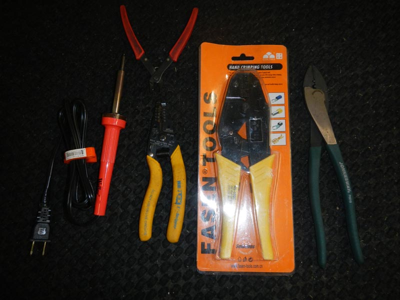

I haven't had it out of the box to try it yet, but here's my arsenal...
I should probably step up my soldering iron, but to be honest I haven't soldered too many of my connectors in the past. This is something I'm trying to change.

Oh - I also have one of those wire holder chingaderas from HF. It's made my life easier a time or 2.
And as far as a list of what's pictured above - the ratcheting crimpers took over for a set of hand crimpers I wasn't super happy with. Again, haven't tried the new ones yet, so can't report on them.
Yellow handled strippers I LOVE. I finally spent a little $ on decent ones and they are so much nicer than the generic crap I've had in the past.
Green handles ones are a generic barrel crimper. Handles are long enough to get some good leverage!
Red handles are a set of the HF "flush cutters". Instead of having a tapered back side to the cutting edge like typical dikes, these have a flat back so they cut whatever you're cutting flush with the back of the tool. These are what saves you from those little cut off tails on the zip ties that always seem to attack you & draw blood!
I was debating on spending the $$ on the "real" ones and saw these for something like $2. They aren't as well made as a quality brand, but have been kicking around my shop for 3-4 years or more now & have definitely served their purpose.
