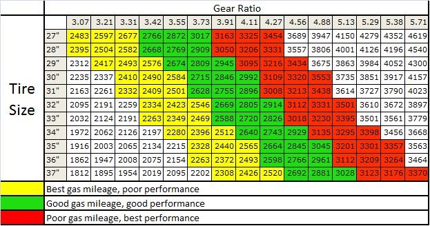

What gears?
Post by Totti »
What gears do you recomend for a Bronco?.. its running 35's with 5.0 and mild build C6..Coilovers in the 4 corners..It would be mainly for prerunning..
Thanks..

Posts: 6026
Re: What gears?
Here ya go.

Re: What gears?
Post by Totti »
Thanks.. in paper Im in the green zone, lets see how it does in the dirt and road..
