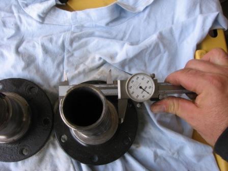

Since I am moving away from the single year 87 hardware I wanted to post some photos to illustrate the differences..my 1987 snout on the left versus 1982 6 bolt snout.

Bondobob wrote:Since I am moving away from the single year 87 hardware I wanted to post some photos to illustrate the differences..my 1987 snout on the left versus 1982 6 bolt snout.
It was actually mid 87 to mid 88 on those. I have seen both years with both types of spindles.
Want to sell the shorties? I could use a few more spares as I made a bunch of aluminum hubs for those years ago. I have 3 people still running them and no spares.........

The spindles themselves (snouts - not the uprights/knucles most people refer to as spindles) are what comes to mind. There is a 5 and a 6 bolt pattern as well as different steps in them for seals, etc.
There is a pic floating around here on somewhere that shows a bit of the difference in the snouts.
Found it - pic in this thread (it's other places too)
http://www.gofastbroncos.com/forum/view ... =26&t=3277
http://www.gofastbroncos.com/forum/view ... =26&t=3277[/quote]
Thanks Chase Truck, thats good info & pic on snouts.
So do hubs interchange on snouts with the correct bearings?
As for Bronco/F150 TTB beams, they are all the same?
If you think you can or think you can't...you're right!
Re: TTB vs. THE WORLD (AKA differences between Ford TTB axles)
I believe the beams themselves are all the same between the d44's found on the broncos & f-150's. The early years had the bolt on axles vs. c-clip, but aside from that center sections are the same I believe too.
Never tried swapping the hubs onto different year snouts by changing bearings so I can't help you there. Maybe when Philo gets back from the 500 he can chime in.
Beams are all the same between Broncos and F150s.
Hubs can all interchange with the exception of later ABS have a little bit more machining for the reluctor ring. If you don't need ABS it does not matter.
Spindles need to match knuckles. There are two bolt patterns five and six bolt. There are several differences in the five bolt spindles, ABS and Non ABS, as well as inner bearing and seal differences.
