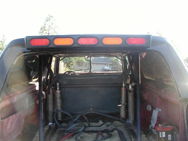

Re: Bench seat vs. 2 seats in rear
my shocks comp thru and run right at the back of the seat. it is in the stock position(the seat) they are 14"
As far as the shocks go you can achieve good angles with the back seat in the stock position mine are very similiar to scotts and I run a short body 14 quad bypass a 16 will fit.
Bajascott- did you make or buy your rear light bar? How does it attach to the shell? I'm looking into building/buying a similar set up. Thanks
