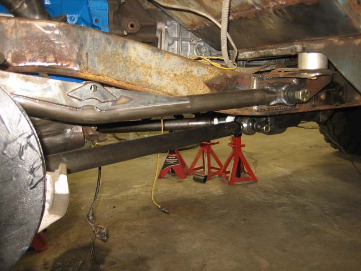

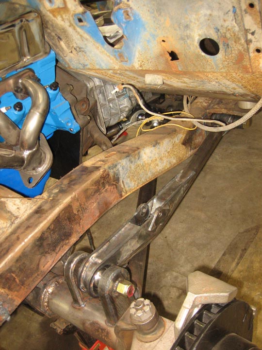

You could always 4 link the thing Dust... Here's a little "backwards" version a buddy did on a '71 bronco. And NO, that mount for the upper link is NOT done.
x 294.jpg (95.48 KiB) Viewed 1475 times
0 001.jpg (72.36 KiB) Viewed 1475 times
rob 71 bronco.jpg (106.39 KiB) Viewed 1475 times

ChaseTruck754 wrote:You could always 4 link the thing Dust...
I've looked long and hard at this option.
I could still talk myself into it but... I'd only do it with a Panhard and at that point there is not much of an advantage over the RA, and the RA while it generally has huge anti-dive numbers is to me a known quantity, or I've BTDT decades ago and made it live.
Steve,
Can you post some more pics of this thing in the early bronco section? I would love to use some ideas on mine!

If I must... It's a cool truck and I might as well share.
Dust - another thing I like about the 2 piece radius arms is the caster adjustment it allows. Not that it's a major benefit one way or the other but if you decide you need more caster you turn that upper link and you got it...
