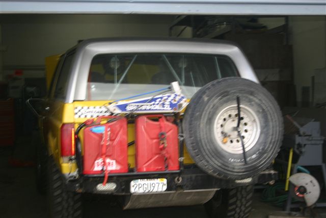

I really like this set up but if I go this route I'd mount the spare tire on the driver side to free up some of the blind spots in the right rear:

Here you go Scott, it's the Bronco that Solo Motorsports built:bajascott wrote:i'd like to see more pics of that bronco,if you have some....
http://solomotorsports.com/images/1988P ... index.html

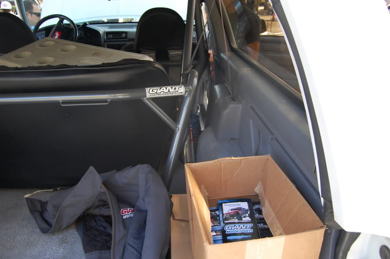

What have you done to the back half of your interior after a cage or even without. Im looking for some ideas for my Bronco. Pictures
I was thinking I wanted to do something like Giant did with theres

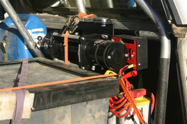

Here are some photos of the back of my bronco. There are tie down loops on the cage and floor. I made a metal frame to fit over the plastic totes which keeps them from moving. The winch drops into a receiver that is tied into the cage. Ahead of the cargo area I have a "convertible" configuration.
Option A) Two gerry can holders with two 6 gal water jugs, and I can stack two 35" tires between them. I use the latch bar in the floor that the rear seat would latch to for an anchor for tie downs for the tires with straps running up the center of the wheel and off to the cage tie down loops.
Option B) Remove the gerry can holders and extra spares and put in the OEM rear seat. I also have a cage cross bar behind the front seats that is on those tubing connectors so I can remove it and leave it out when I am using the back seat. If I'm going to run it hard, it's configured as a 2 seater with this extra cage bar installed.
I also have a bikini top that snaps onto the cage when I take the shell off the truck. The back seat is a very nice place to travel with the roof removed and the bikini top for overhead shade. This is summer beach cruiser mode.

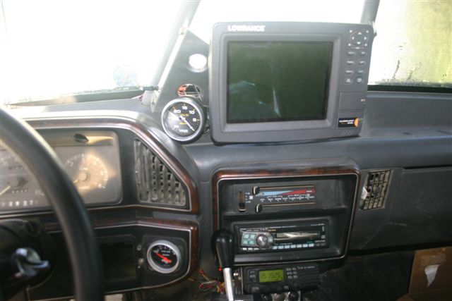

That looks good! I am loving my Lowrance 840! So much easier to see. Do you have any issues blocking your vision with it mounted up on the dash like that?
- baja-chris
- Posts: 712
Re: Rear cargo storage sollutions.
From my line of sight the top of the gps is about even with the front right corner of my hood. So it does not block my view of the dirt.

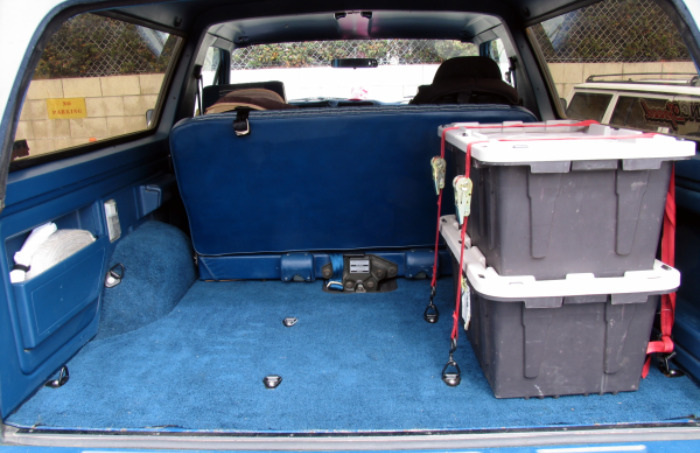

Here's my non-caged cargo area. I have more anchors to add in front of these for when the seat is folded
