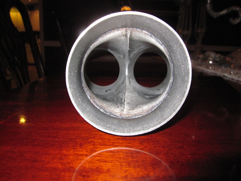

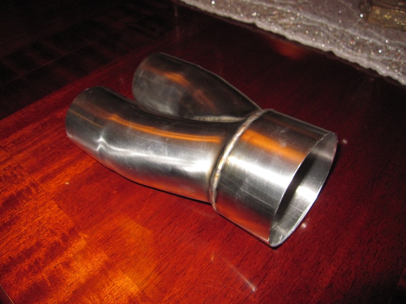

The Y-Pipe has arrived, and I'm very happy. Here are pics:
The only thing I realized I forgot is the nipple for the crankcase breather tube. So either I port the breather tube into one of the two intake tubes, or I weld in a stainless barbed nipple into the new Y-Pipe.

Not bad for $95 or so, right? I'm looking forward to seeing if it makes a difference on the butt dyno.
Re: Custom Stainless Steel Y-Pipe for Mass-Air - Any Interest?
While I have a very hard time paying others for fab on something I could make I've gotten in the habit of thinking more about stuff like this and pricing lately. My thought process is now something like:
Well, I charge $95/hr when I fab for people (that's more of an IF than a when) and with materials cost and then the time (I always think I could do that in an hour, but I never could) it factors out that it's just easier to buy the piece. Still - I'll probably end up being stubborn and making one.
One thing I would have done and it's just because I'm a PICKY bastard is to bead roll each of the openings to put a little bead/lip there for the hose clamp to "catch" once you clamp the tubes/hoses on.

ChaseTruck754 wrote:One thing I would have done and it's just because I'm a PICKY bastard is to bead roll each of the openings to put a little bead/lip there for the hose clamp to "catch" once you clamp the tubes/hoses on.
Yup, that was another thing I forgot about and that got left out.

Call Chris, he really did a great job. Don't forget to ask him to put a breather fitting in and a bead roll at the end of each opening if you want one.
