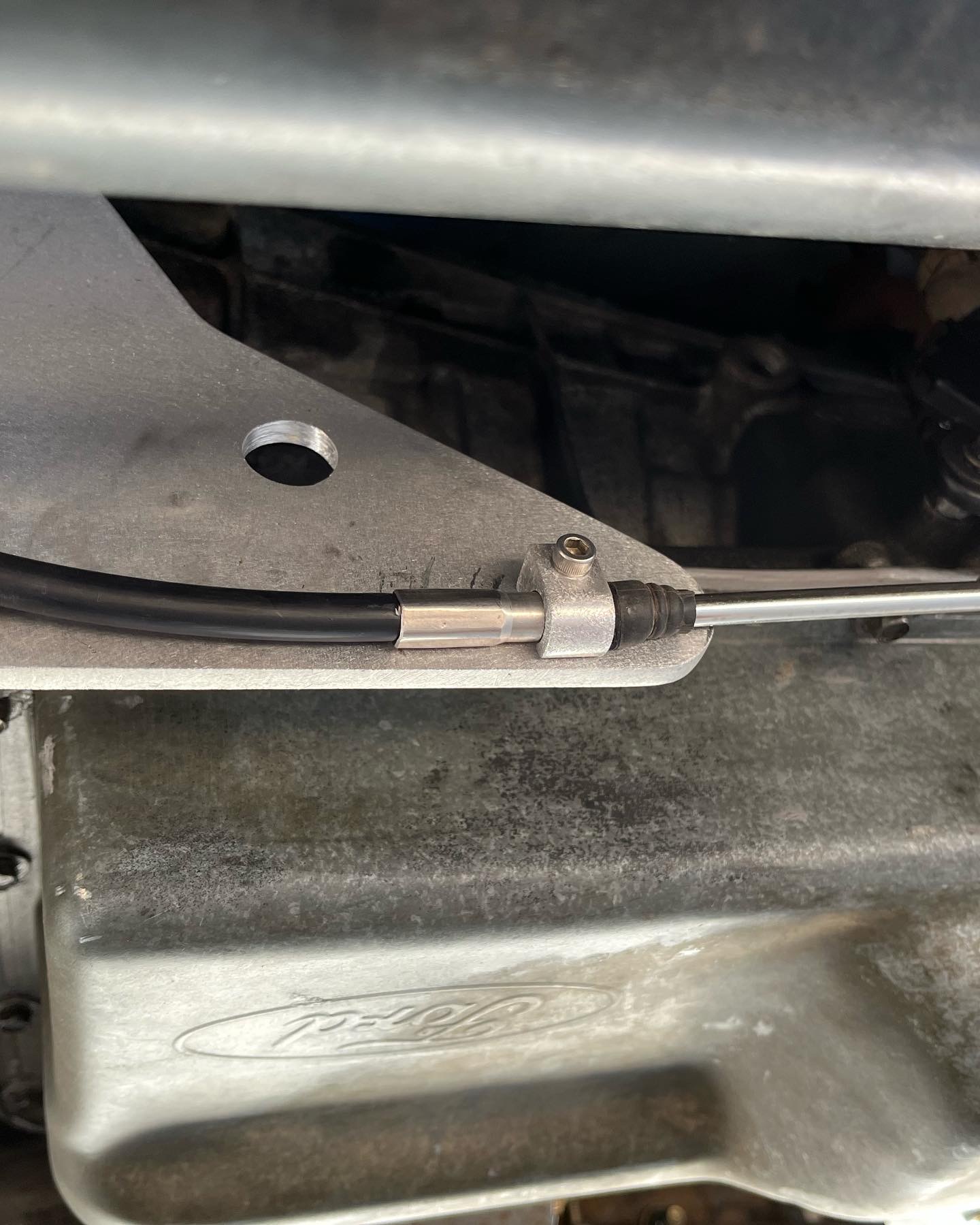

As far as I'm concerned-- my shifter knob in conjunction with an Art Carr is the closest one can come to easily and safely shift the E4OD out of OD and into third -- when I say safely I mean in the dark blind folded you can easily and quickly find the floor shifter on your vehicle. Add my transmission bracket, it's by far the easiest and cleanest way to mount and route the shifter cable by going thru the factory transmission firewall hole.

How does that make it a manual 4 speed?

It doesn't make it a manual 4 speed but it allows you the best ability ti down shift with a no look from 4th ti 3rd or back-- on the column is clumsy and on a panel in the cab as well. My set up isn't the cheapest but it's the best way to install a floor shift E4OD at this point.
The 4l80 is the best option but it's thousands more money and let's face it my skill set is way higher than the average like yours is as well. Lots of guys can do bolt on swaps but many aren't their own fab guy.
