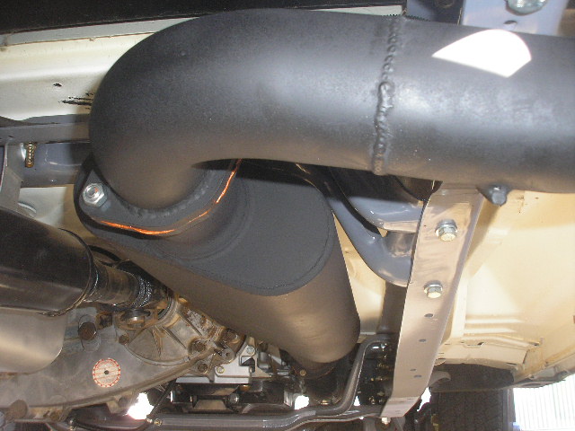

I’m with bonfobob, I have stock y-pipe and cats withthe rear cat opened to 3”, no muffler. Sounds great, dual cars muffle it plenty. No if I could only hear it over my bypasses. ImageImage Here is a unique perspectiveImageImage
Re: Muffler Options
My set-up:
