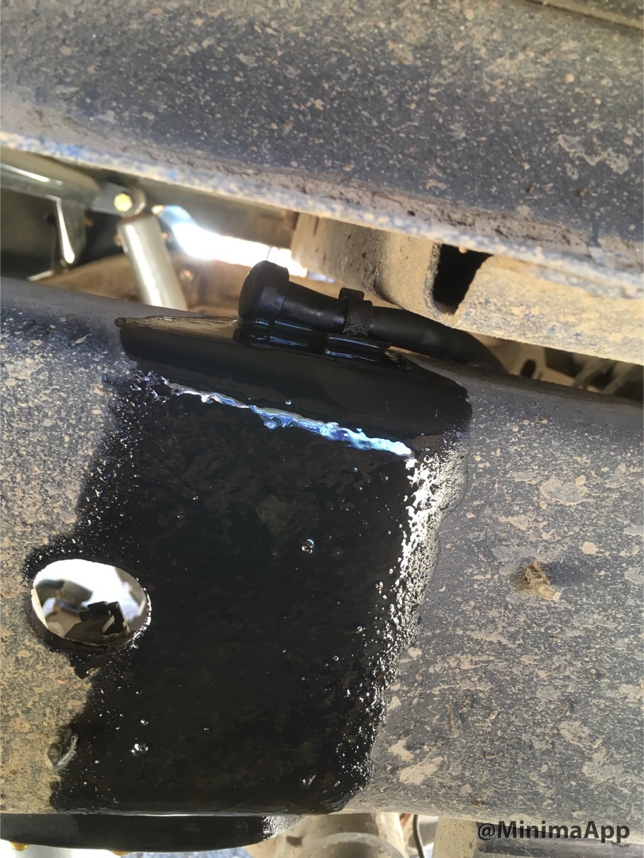

Hey doodes I’ve been having an issue with my rear diff breather pukeing fluid any help would be appreciated I cannot seem to figure it out please help

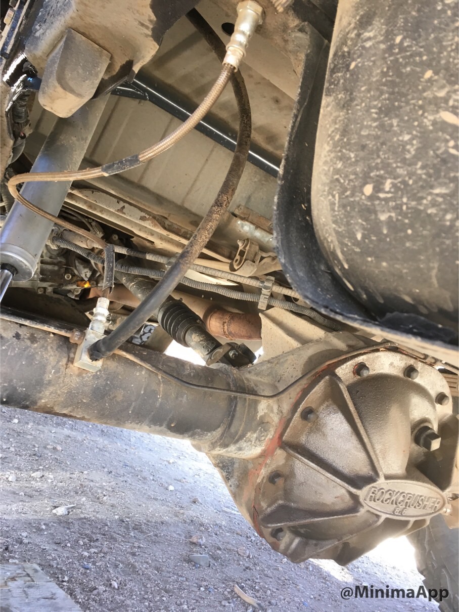

Post by wookiee156 »
Here’s picks by the way I’m about to cry over this help help

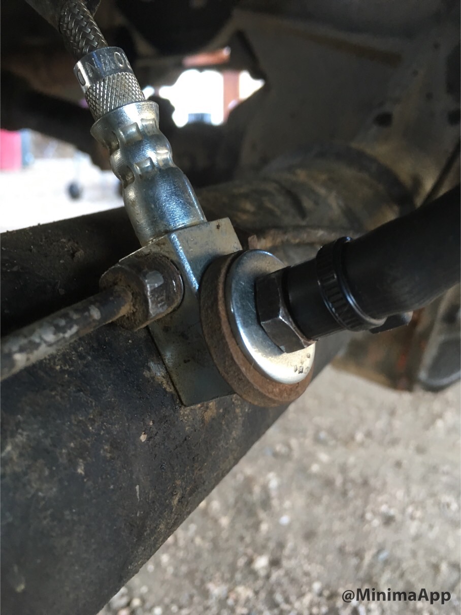

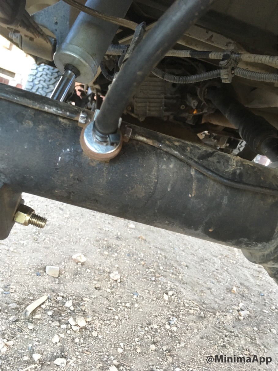

Sooo here’s a shot of what I think (more like hope) is the fix
Side view of spacer aka washers
Front shot
Front shot
Re: Rear breather leak??? HELP
Let us know if that works! I do know the stock block has a pretty big spacer/gap built in there

Sooo woke up this morning annnddd no puddles so far so good gona take her for a drive and hopefully over the next few days no more leakage (crossing fingers)
