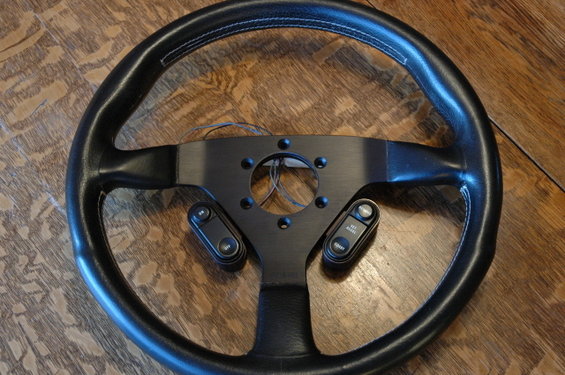

The Grant stuff was ugly and I refused to pay the price for aftermarket crap. I used a replica bracket for a Saleen Mustang on mine. It uses factory switches (better than aftermarket). I'll see if I can find contact info for the guy that was making them.
Not my steering wheel....
Re: Cruise Control with a custom steering wheel.
SteveG wrote:The Grant stuff was ugly and I refused to pay the price for aftermarket crap. I used a replica bracket for a Saleen Mustang on mine. It uses factory switches (better than aftermarket). I'll see if I can find contact info for the guy that was making them.
Wow, that looks pretty darn good! Almost wish I had cruise control! :cry:
It does look good. Nothing a guy with a plasma cutter & sander couldn't whip up if he had to!

The part where the switches fit are pockets and would require milling. The guy I got mine from is a machinist... the part has been long discontinued so he borrowed one and duplicated it. I don't know if he ever did more runs or not, but it was a really nice part.

Well if you have a mill that can work too. If you aren't using yours & you're cool with it - I could borrow it, convert it to a cad file & people can use that to have new ones laser cut or water jetted. Both of these methods are better than the plasma I mentioned before - I was just saying if one wanted to - he could with that stuff.

If I'm not mistaken, they have different resistances. They all use the same wire through the steering column, so they have to send a different signal to make the cruise control respond appropriately.

The older ones didn't....no biggie... just need $4 worth of resistors from Radio Shack.
