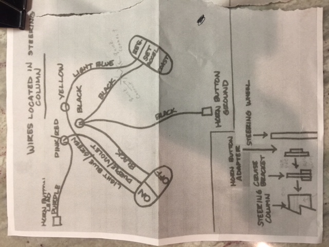

To help those looking for adding a wheel and keeping the CC there is a guy named George Gast and he says:
"You can txt me at 678-eight eight two-4278. That’s my cell. I make the cruise control plates and the retainer caps that go on the back of the buttons. I charge $225.00 plus shipping and I accept paypal. You have to cover their fees or pay as a friend/gift. I can send you pictures if you like. Just txt me."
His FB name is George Gast to reach him there.
Does anybody have the button part numbers to make this thread a slam dunk for those looking to do this?

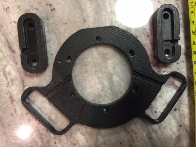

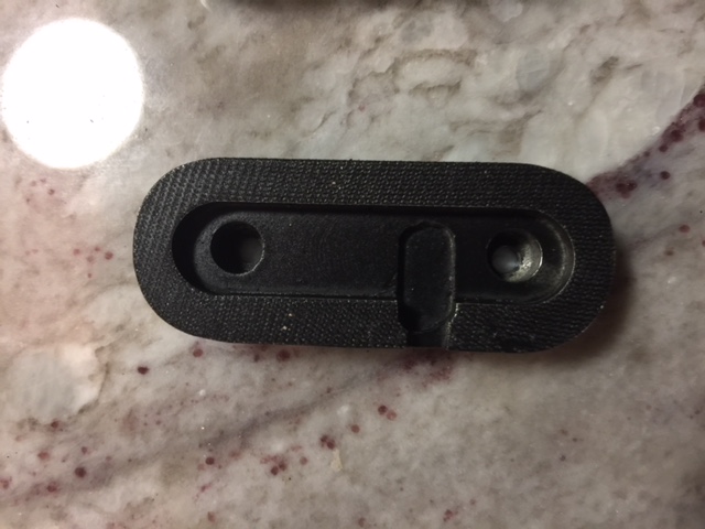

If anyone gets a kit from George - take pics. He machines them & I want to see why. Willie has one of these & I was thinking of borrowing it, measuring it & making a cad file to have parts laser cut. Wondering if the things really need to be machined for some reason, or if I know the cut thickness on the laser if I could just adjust the cad file for it & be fine.
Re: Steering wheels!
ChaseTruck754 wrote:If anyone gets a kit from George - take pics. He machines them & I want to see why. Willie has one of these & I was thinking of borrowing it, measuring it & making a cad file to have parts laser cut. Wondering if the things really need to be machined for some reason, or if I know the cut thickness on the laser if I could just adjust the cad file for it & be fine.
I will get it to you ...so you can look at it.
Willie
Thanks. If you do I'll just make the cad file so it's here if needed. Based on what I've seen of yours (pics) I don't get why these would need to be machined. I'm interested to see why Goerge machines them. Other than he's a machinist by trade, so that's just how he does things. I'm also interested in seeing what his finished piece looks like for the $225 price tag.
You laser the a-dapter...machine the button pockets. I really hope he is not actually machining the whole thing unless he has a machine shop but not a sheetmetal shop!

George Gast. CC bracket photos. Anybody needs more info Just PM me
Thanks for posting those.
