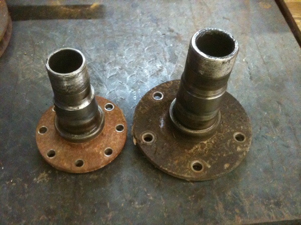

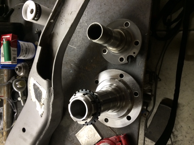

philofab wrote:I have never seen coils on an F250 TTB, 44HD or 50.
Dana 44HD uses 44 ball joints, larger spread, but same snout size on the spindle with 8 bolts holding it on. Beams/pivots are the same as 50 with the exception of the lower ball joint taper.
Philo the Dana 44HD uses the same upper bearing and larger lower bearing like the 50 on the snout. I have attach Pic side by side of Dana 50 and Dana 44HD
The second Picture is of Dana 60 and Dana 44 ....as Philo has educated me in past years Dana 60 and Dana 50 are 95% the same. so this gives you a idea on all 3 ford TTB snouts.
- funinthesun95
- Posts: 1701
Re: Dana 50 into 44 housing.
Sorry Philo I did not see this before my post...on the inner bearingphilofab wrote:baja-chris wrote:Can you fit either 5 lug or 8 lug hubs on that 8 bolt 44HD spindle?
The index ring for the spindle to knuckle is the same other than having an 8 bolt pattern vs the 5/6 the regular 44 has. I can not remember if the outer axles are the same. I know the outer bearing the same between the 44 & 44HD but I think the inner is slightly larger on the HD. It might be able to be done with the correct bearing combination.
