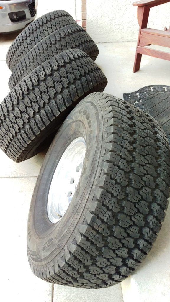

Yup...had Goodyear Silent Armor 35x12.50R15's on my stock Ford 15x7.5" 10-hole ("riveted") aluminum wheels (Hollander H1701) for 7 years...just replacing them in August with General Grabber red letters in 35x12.50R15 on American Racing AR23's, in 15x8. No issues with either set-up.
- Goodyear Silent Armors in 35x12.50R15 (no longer made in that size...)
- IMAG2080-20161009-183529687 - Copy.jpg (233.03 KiB) Viewed 2572 times
