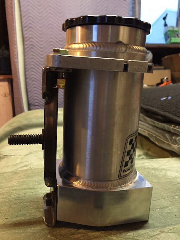

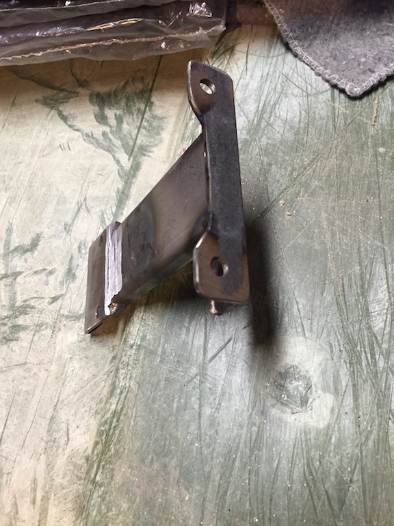

update: I mentioned I was going to go with Howe, but after researching I have decided to go with PSC, purely for economic reasons. Howe makes really great stuff, but for just shy of half the price I have decided to try PSC. I was geared up and ready to knock this project out today. I didn't realize it was going to rain today, so I didn't get anywhere close to completion. I don't have a covered area to work on the truck, so I was limited to the garage which is just big enough for my junk and no vehicle. So, with all that said I spent some time fabricating a bracket to mount the remote reservoir. I hope to have another update tomorrow with more pictures.
Re: Sag pump conversions
Bracket looks really good!
