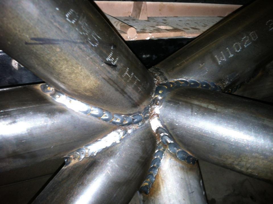

Favorite junction on my bronc haha
Re: Need End-mill Notcher Vice Ideas.....
Same reason I never did get around to setting my lathe up to do this - my JD2 notcher works fine. I have the middle of the road JD2 now (notchmaster) and it does offset notching, but my ranger was built with the basic model (TN-100) and it did just fine. I had plenty of junctions like you picture above. I'd just do extra cleanup of the high angle notches with an angle grinder.

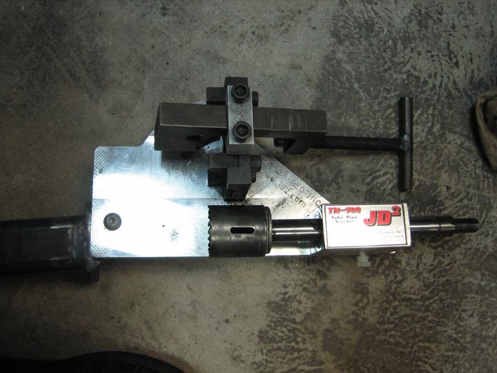

I personally have my notcher set up on a hitch type setup & it slides into the hitch receivers on my tables like all my tools do. I run it with my hand drill vs. a drill press.
Here's the old JD2 on the hitch tube. Don't have any pics of the notchers plugged into the table but it works really well for me this way!

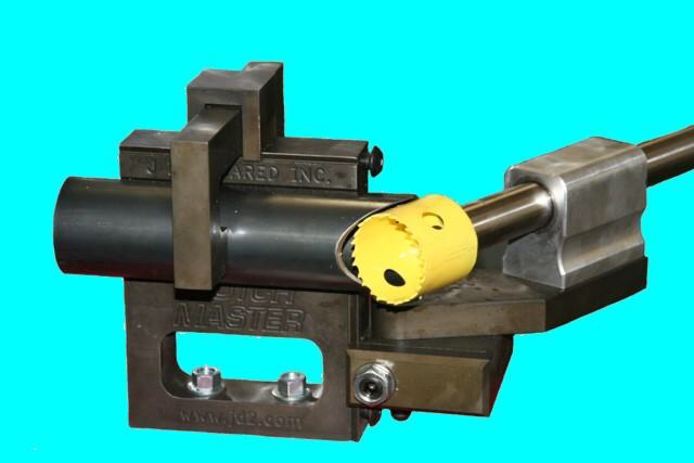

Here's examples of the swivel style.
- image.jpg (52.42 KiB) Viewed 675 times
- image.jpg (58.56 KiB) Viewed 675 times
- image.jpg (40 KiB) Viewed 675 times
