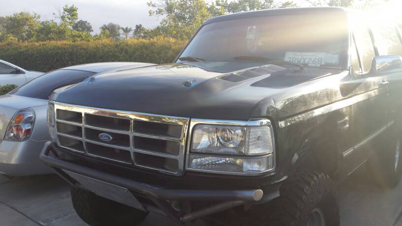

Love the new hood and so do my friends. A lot of people asked who i got it from so you might be making a few more :)

I still need to do some more adjusting and get some longer hood pins but....here you go
[attachment=-1]uploadfromtaptalk1402365736935.jpg[/attachment]
[attachment=-1]uploadfromtaptalk1402365748195.jpg[/attachment]
