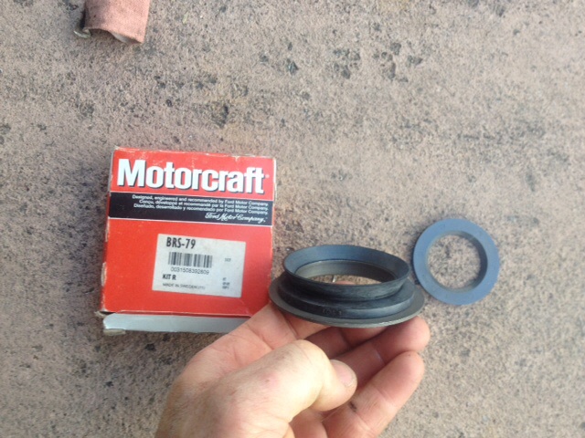

This motorcraft axle to spindle seal is the only one that fits like it should. All the rest I found are not correct in size or shape. The national seal looks nothing like the motorcraft.
