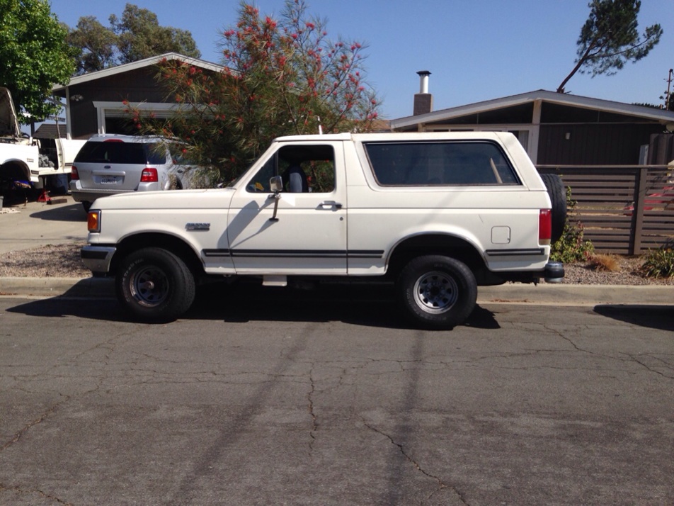

Here it is the day I picked it up. I got it for $700. I am trying to make this as cheap a project as possible.

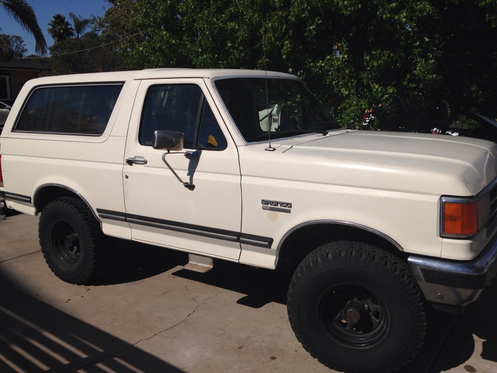

Haha I'll put some of the pan tomorrow. It's on 33s now.

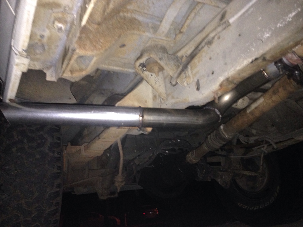

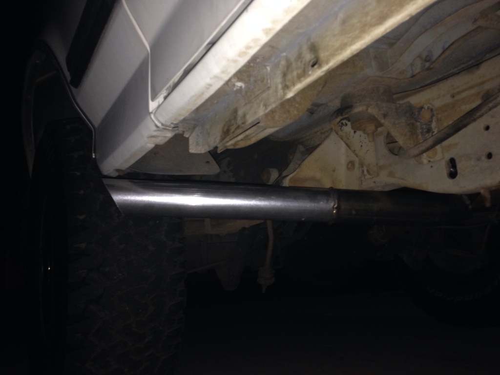

Here are some of the exhaust I built today.
Sorry it's dark out. It's running a little rough and I'm not sure why. Put all new plugs, cap rotor. New air filter, fresh oil change.
It sounds like a loapy cam.

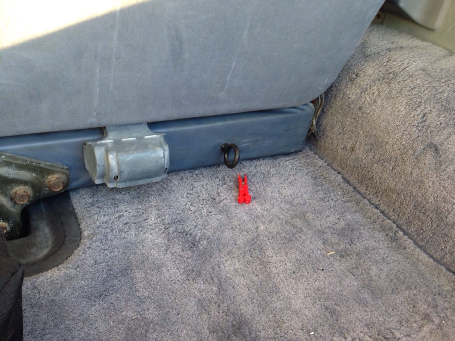

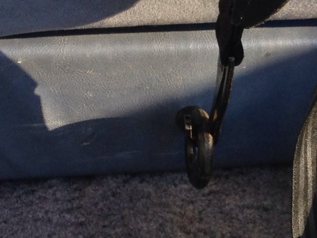

Modified the rear bench for the child seats.
