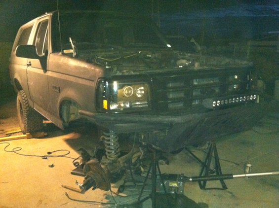

Here is before I built the bumpers.

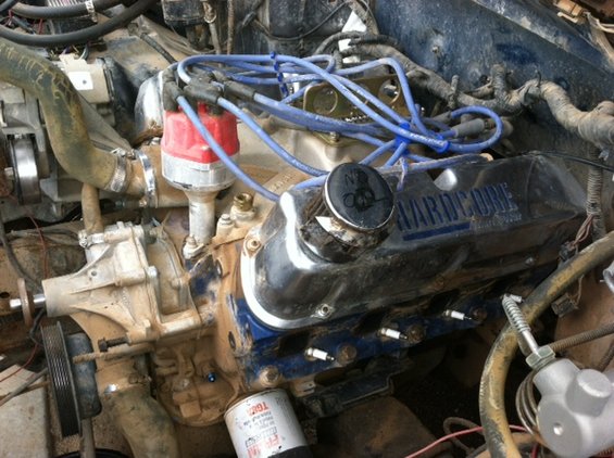

I have great news!!
I just got an 88 f-250 4x4 that has a 414w, c6, and 208 t-case!
Motor is fully built, c-6 is fresh.
It has world products heads, probe forged pistons, I-beam rods, it has a small cam .476 lift, it has a holley 750 vacuum secondaries, dual plane, msd billet dizzy msd ignition. 10.3 to 1 compression, has it tuned for 91 octane. NIce radiator, it has longtube headers, i don't know if that is going to work out.
So anyway now all I have to do is pull the goodies out of the f-250 pull the motor and tranny and I guess t-case out of the bronc, and swapola I'm done lol.
SO I have a few questions for you all...
Can I use the np208 t-case and c-6 and keep my driveshafts?
Should I just pull the motor out of the bronc, and drop in the 414, and run the e4od?
Can I run the 414 and c-6 with my t-case? 1356 I believe?

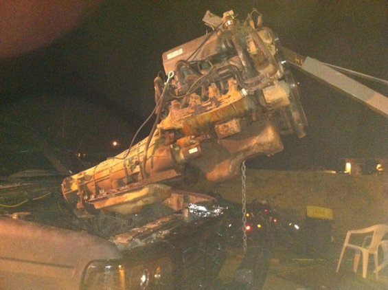

Ok, after some research, I am going with the c-6 bw1356 combo.
I was planning on doing the suspension first, but I couldn't pass up the deal on this motor/tranny. The guy I got it from had a build file with the motor, he put over 9K into it! He fired it up for me before I got it, it sounds mean as hell. Idles real nice, it has instant throttle response.
The motor has a nice mild cam, and the tranny has stock converter, so it will be perfect for off road. It hasn't been dyno'd but his estimate is 450+ ft lbs.
I'm wondering how long my 8.8 will survive under those conditions.

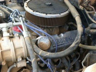

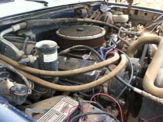

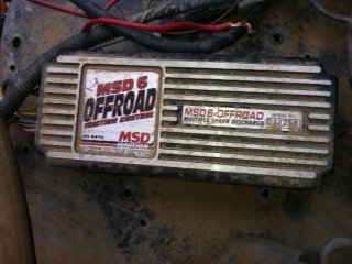

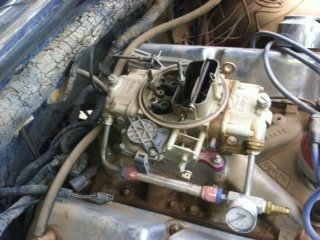

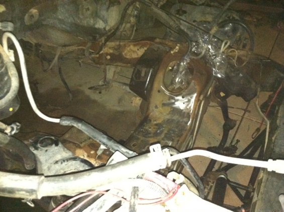

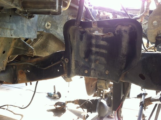

All right, here are some pics of the new motor and donor truck.
https://www.flickr.com/photos/122332664 ... 630461415/
https://www.flickr.com/photos/122332664 ... otostream/

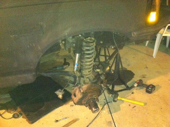

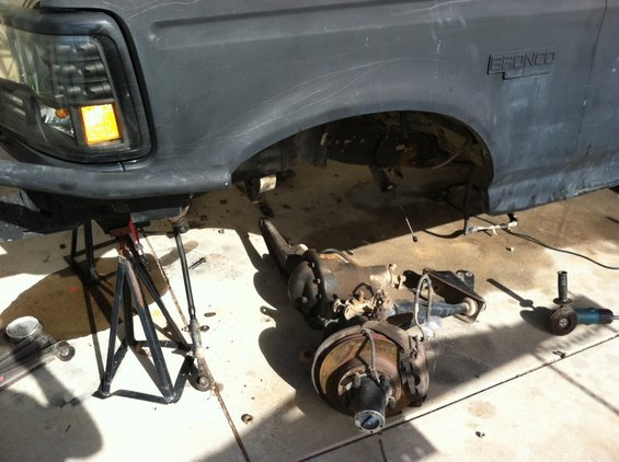

I just ordered c&t beams, radius arms, rear shock mount and shackles from Threat!
- keenanduran1
- Posts: 559
- Location: Dana Point, CA
Re: The Beast
I have the Threat Kit on my Bronco with the same suspension set up basically. 4.5" over beams with 2.5 14" coilovers with 350/500 and 2.0 2" bumpstops. for the rear i have the shock towers, shackles, Q80's, and 2.5 12" double race series. Good luck on your build
- Hauls Assington
- Posts: 295
- Joined: Wed Oct 23, 2013 5:44 pm
- Bronco Info: Under Construction
- Location: Las Cruces , NM
Re: The Beast
Nice! How hard can you drive it without breaking stuff? What should i look out for while putting it all together?
- keenanduran1
- Posts: 559
Re: The Beast
Im in the process of putting the rear suspension together. Call solo motorsports and get the adapter kit for the q80's so you dont have to cut the body and get the spacers for the front hanger.
- Hauls Assington
- Posts: 295
Re: The Beast
I'm running j40s with threat shackles, it's supposed to go right on lol.
