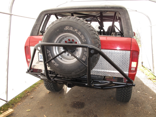

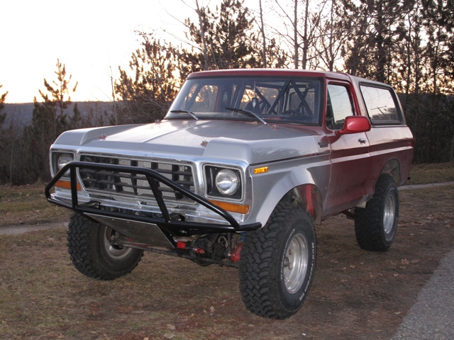

I just wanted to post my Bronco so I could get other solid axle prerunners to post on the cite. Here are some exterior shots:

Very cool! Welcome to the site.

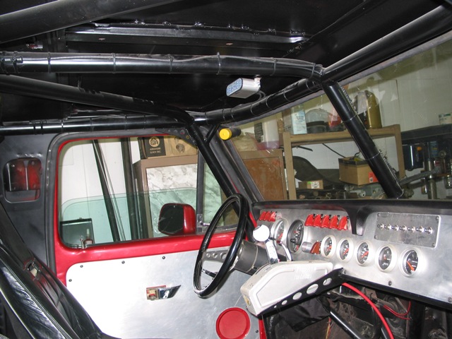

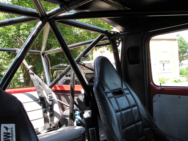

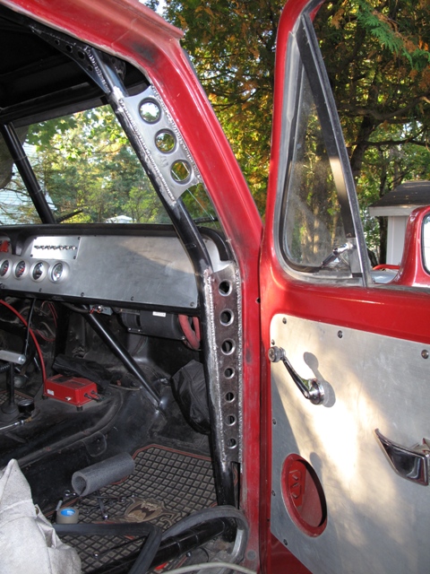

Sample pictures of the interior.

Kept the old style dash.

Your cage is very well done!

Nice. I'd like to hear some specs on your build. It looks very clean. Is that an autofab drop center hood? My 78 just went back in the shop for its final suspension and odds and ends, I'll snap some pics when were done in a few weeks.

No - he made it - and I think it looks awesome!

Baja Dale yes I'm from up north but on the East side, the province of Québec. Concerning your dads Bronco is it full fiberglass? The hood on it look's like the one I made for my Bronco. I drop the hood down with an 81 Bronco centerpiece and made a mold for future pieces. Regarding the Bronco ,what kind of motor and mods did he do to make it raceable?

78CLASS3 as for my Bronco, it’s powered by a 460 with standard mods, head porting,cam, intake,carb etc. The transmission is TCI built reverse valve body E4OD low gears etc. The front suspension is a 3 link and the back has a 4 link with king shocks and bump stops all around. Gearing is 4.10 but soon to be 5.13 with the 37BFG’s. Detroit rear and posi. Front.
