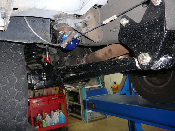

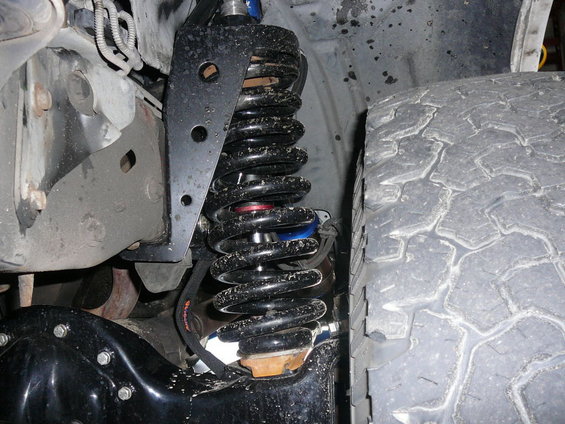

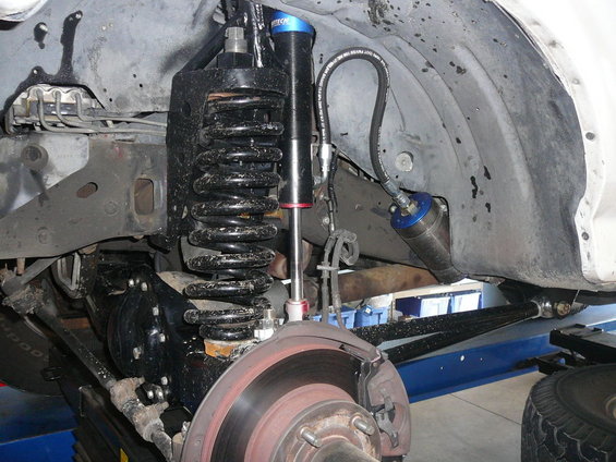

As with everything else in my life that goes awry, now i'm having computer issues, and can only get a few pics at a time. No action shots, just some pics of the finnished suspension. I will add more as i can.
