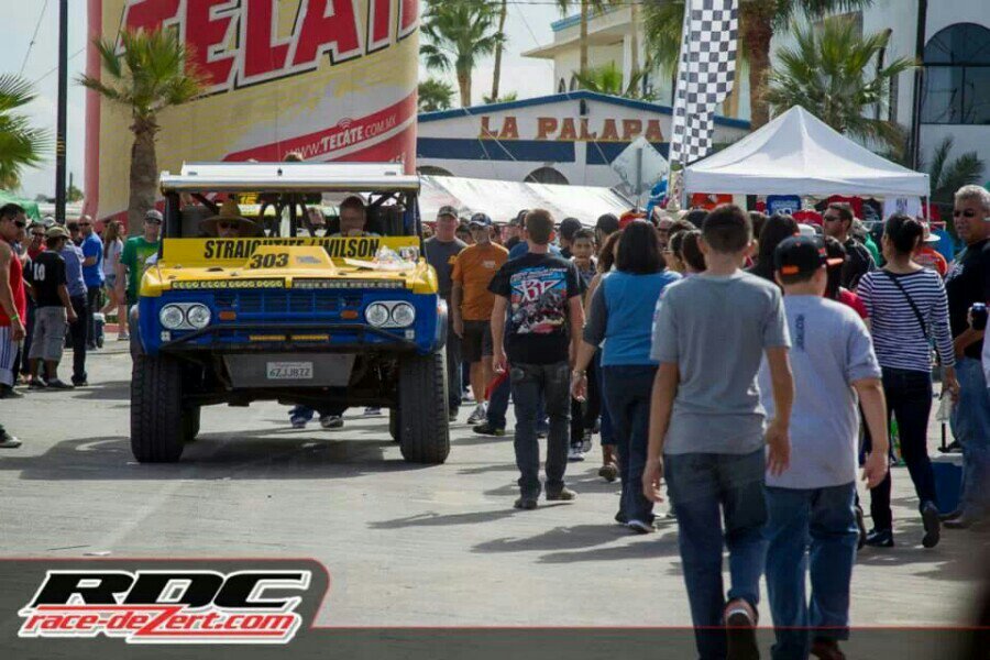

First pics are on the trailer. Then in the line on the way to contingency
The black on black driver names did no com out so a little yellow spray makes them barely readable.
Still missing PCI and SCORE stickers

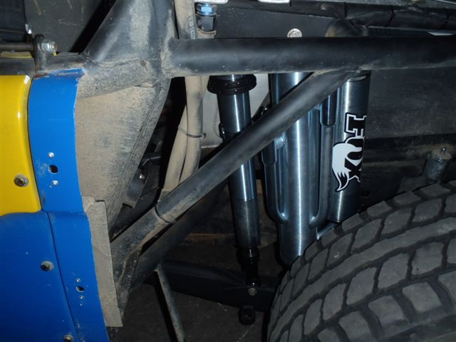

The leaf springs we ran at the 1000 turned out to be too light of a rate, we had only guessed when we ordered them mid-build. Now that we have a complete truck we were able to weigh it. National Spring is making new leaf springs that will hold up the rear of our tank. We ended up at 6400 lbs with drivers and fuel. All steel body, iron 205 transfer case, OEM 4wd parts, 80-gal fuel cell, etc. It all adds up and we are 1000 lbs heavier than we had hoped for. Should of used thinner aluminum for that big wing!
We fixed the issue we had with the front end (the upper ball joint cup was loose and tore out of the beam at the 1000) and addressed other new car blues issues. Upgraded the size of the alternator for example. We have also fit all new FOX Shocks. 4.0" 5-tube bypasses plus 2.5 coilover (without coils) plus 2.0 air bumps for the rear. 3.5" 5-tube bypasses plus 2.5" coilovers plus 2.0 air bumps up front. We are using the AGM coil spring dividers/sliders on the front coilovers. We plan to continue to spring the rear only with leafs. The rear coilover is just used as another shock. Both FOX and National Spring have been great to work with so far. Here are a few pics of the new shocks. The front mounts are not quite done in these pics. We should be mounting our new leafs this weekend and testing next week.

Nice! You realize those new shocks added over 100#'s. Did you figure that into the new spring rate?
- baja-chris
- Posts: 712
It's ok, we filled them with light oil and helium instead of nitrogen. And if that does not do it, then we invert the wing to lighten her up.BDKW1 wrote:Nice! You realize those new shocks added over 100#'s. Did you figure that into the new spring rate?
I think it was Walker Evans who once said he never saw a truck broke down on the side of the track because it was built too strong or too heavy.

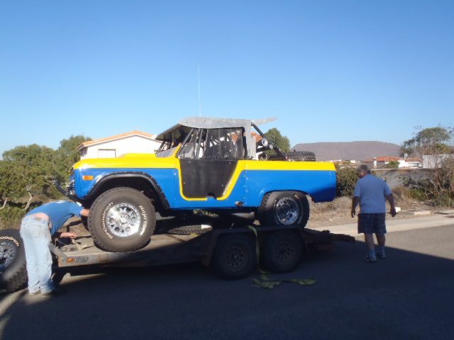

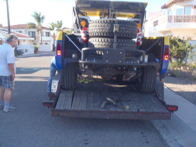

Chris and the Bronco spotted in San Felipe. [attachment=-1]uploadfromtaptalk1393685386539.jpg[/attachment]
- uploadfromtaptalk1393685386539.jpg (127.34 KiB) Viewed 1938 times
