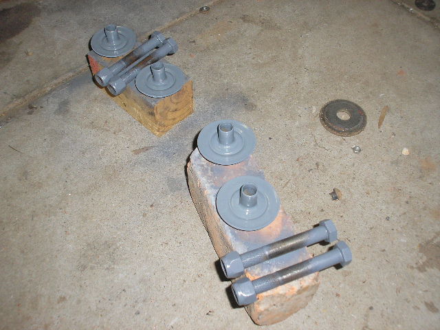

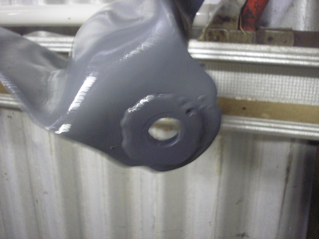

Thursday update:
Well, it has rained since 9:30 pm last night, and it is WET outside I got my spring hangers sorted and they are primed in the garage tonight: These washers were added by a PO, so I just rewelded the bird droppings that were there and buffed them with a sanding disc: I primed the cab mount nuts and the rear spring bolts and nuts ready for paint tomorrow night: I'll have all the hangers fitted Saturday morning, and start on the steering box and linkage after that. Then, if its stopped raining, I will buff up the rear leaves and hit them with cheap black and fit them as soon as they are dry.
Stay tuned

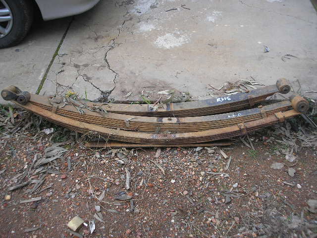

Saturday update:
Got my spring hangers bolted on today, and used the last of my bolts and nuts too: I will start on the PS box later, wash it up and paint it and start prepping for the steering.
In a spur of the moment thought, I put a FSJ spring against my F100 rear spring, and it is the same length and width, and the spring bolt is in the same position. I have a pair of 5 leaf with overload FSJ leaves out back, maybe I should try these to soften the rear a little. The FSJ springs also have more unloaded arch and the springs I am considering do ride nicely with a light load (ie: full fuel, 2 spares, jack etc. I picked up the 9" bearings, but got the wrong ones in the boxes. It seems someone swapped boxes somewhere at the supplier. My auto shop will have to correct ones on Monday, so I will pick them up then and take in the 9" housing for a quick blast too. Assembly and paint next week. Cant wait to get this thing into a roller

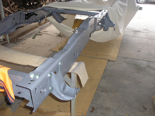

Re: Rod's 84 BabyBajaF100
Sunday update:
Got the PS box cleaned up, painted and fitted today: Notice the depression the factory formed in the X member to clear the piston housing on the PS box. Thats standard on all F Series and Broncos here.
The steering linkages I will clean up during the week, and get them on along with the new tierod ends. Cleaned and painted the coil retaining clips, park brake relay stuff and proportioning valve mount: Laid out the brake, canister vent and old fuel lines ready for cleaning. Laid the harness out, too, ready for unwrapping and redoing: Getting closer, slowly
Wednesday update:Balls wrote:are you going to add any bracing between the ps box and frame? The boxes tend to move and flex the frame a lot if just the three bolts are used, in some cases the bolts will fail. I've seen a few different setups that brace the box using the already threaded hole onion the upper vertical sideof the box on the frame side.
Rather than write a new post for this, I decided to modify this one. Balls reminded me of the weakness of the steering box area on these Aussie versions and I decided after mulling it over for a few days, to inspect the whole mounting system to see if I could improve things...... Boy could I.
A seriously closer inspection (should have done this before the install) revealed that someone in the past had welded machined spacer washers to the PS box mounting bosses: An even closer inspection revealed A) the bolts were only engaging the threads in the bosses about 6 - 7 threads because of the spacers. I also found that 2 of the bosses had very bad threads in the first few, which would mean the holes would likely strip out in the first harsh use, so I took the box to work today and whipped those suckers off carefully with the angle grinder: I then used a sanding disc and very carefully cleaned up the bosses and prepped the box for the next phase, drilling and tapping the bosses to 1/2" UNC: I checked the tapped holes with a new bolt, chamfered them lightly and put the box away to take home and prepare the re-fit.
The next step, I took the factory bolts to my local supplier and got 3 new 1/2" UNC Grade 8 bolts the correct length to replace them. These dont have the factory relief on the ends, so I get another 2 threads of engagment into the holes on the box:
Now I have a full inch of clean, solid thread engagment in the mounting bosses (13 TPI in UNC) instead of barely 6. All that remains for me to do is drill out 2 of the chassis holes to 13MM (clearance for the bolts) and drill the 2 large washers to the same size, re-paint everything and re-assemble. Box ready to fit once the holes are drilled:
I have also had a change of mind on the bolts for the frame. I am using Metric 8.8 Grade bolts and 9.8 Nyloks, but I am changing all the suspension mounting bolts to 10.9 (slightly higher than Grade 8). The factory suspension hardware is all 10.9, so I figure its better to use the same for all my suspension attaching hardware. Factory chassis hardware is 8.8, so the body mounts wont change (for now) until the next major upgrades, when I will swap everything for 10.9 hardware right through. My supplier doesnt normally carry 10.9's in stock, so I took what he had and ordered more to do the changeover. I will fit them once they arrive. The few I could get will go on over the next couple of days:
I havent heard back from either Philo or Baja Scott re: the parts I should have coming my way, so I will tackle wiring, brake and emmision piping and other small detailing over the next few days, and start the assembly of the 9 inch and cleaning/painting of the springs. Thats it for tonight, I'm going outside to drill the frame holes, paint and prep for the PS box re-install tomorrow night. Adios, muchachos
Wednesday update #2:
What can I say, I went out, drilled the frame tubes out, cleaned and painted, then fitted the box up. I had to nick a thread and a half off one bolt to stop it bottoming out before it went tight, but I have full thread engagment in all 3 holes and peace of mind (for now)
7/16" UNC to 1/2" UNC upgraded: PS box fitted, torqued and ready: And, it is FREEZING outside it must be 2 - 3C out there. Anyway, done, and done. More tomorrow night, kiddies.

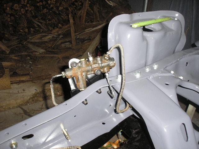

Thursday update:
I got shit done tonight Spent about 4 hrs out there, cleaning the brake and canister to tank vent pipes with scotchbrite and the wire buff mounted on my spare grinder. Installed all the steel brake pipes (I didnt clean them to bare metal, only back to the original zinc finish) with P clips and installed the proportioning valve. This I will touch up later:

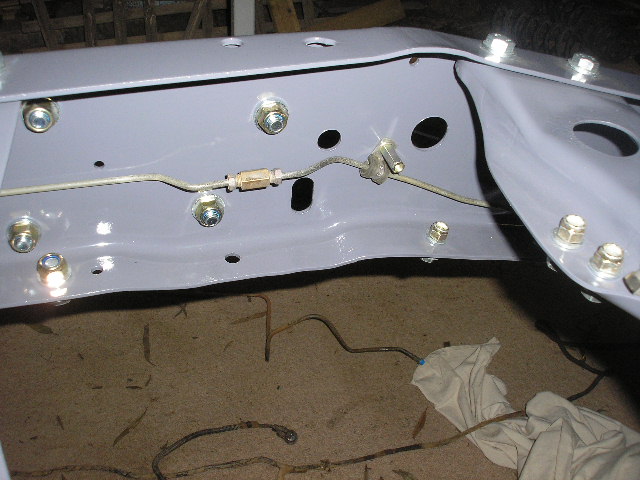

The P clip attatchment detail. I use these long nuts to stand off the clip, so I can attach the 2 P clips for the supply and return fuel pipes. The P clips will face the other way, to keep the pipes inside the frame and away from flying rocks, debris, etc:
Also got the PS pipes temporarily fitted, they needed some serious reforming to get them back to their original shape to fit onto the box and follow the frame correctly. These will be scotchbrited and painted tomorrow night. Note the pipes come around the front of the PS box. Because the engine is offset about 2" to the right, in RHD form, the air pump comes REALLY close to hitting the PS box, so the pipes need to go around the front of the box and down to clear the front of the engine and accessories. They will be P clipped together and to the frame to limit vibration:
The pressure side pipe has a JIC hydraulic fitting brazed on, to make the flex part removable/field replaceable:
On a side note, if anyone is heading for a salvage yard in the near future, I need a LWB or SWB dual tank chassis harness from an 86 to 96 F150 or F250 with dual fuel tanks. If you can pick up a good unmangled/uncut one, roll it up, stick in a flat rate box and PM me a price and postage, I will paypal you ASAP. I need this soon, along with my X member (Philo?) I will get more done over the weekend. Nighty nite
I like the long standoff nut idea on the plumbing. Consider it stolen! Thank you!
x2! I'm running the brake & fuel lines in the crew now & just had one edel clamp (P clamp) pointed up from the bolt and one pointed down. I was then just going to zip tie the 3rd line (fuel return) but like this setup much better!ESHALLBETTER wrote:I like the long standoff nut idea on the plumbing. Consider it stolen! Thank you!
