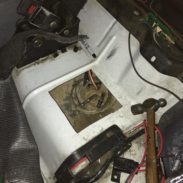

So the Explorer let me down the weekend before I left for the Parker 425... then KOH. It wouldn't start while running an errand. I had no time to work on it during pre-trip prep, so I had it towed to the house. Of course, it started when it got home but I didn't trust it so I left it to deal with later.
While I haven't diagnosed the issue (it hasn't failed to start again), but considering symptoms it exhibited previously, there's a good chance it's the fuel pump and I already wanted to cut an access panel in the floor, so get the panel done and throw a fuel pump, filter and relay at it.
Marking the panel.
Check out this handy little sheet metal nibbler I got from Kelci's grandpa's farm shop when he passed. I seldom use this, but, damn, is it nice to have when I need it!
Here's the final hole. It's just big enough to wiggle the fuel pump out of. The connector for the fuel pump module is sandwiched between the tank and body, so instead of trying to reach up there, I'll add another connector right at the module so I can get to it through the access panel.
Marking the panel.

Hey Steve. Probably don't have to tell you, but check the impact switch. Can't tell you how much I have chased my tail with this one, and how many miles I have run with one bypassed. Being near the coast is hard on them. When it starts one time and not the next, it's suspect.
